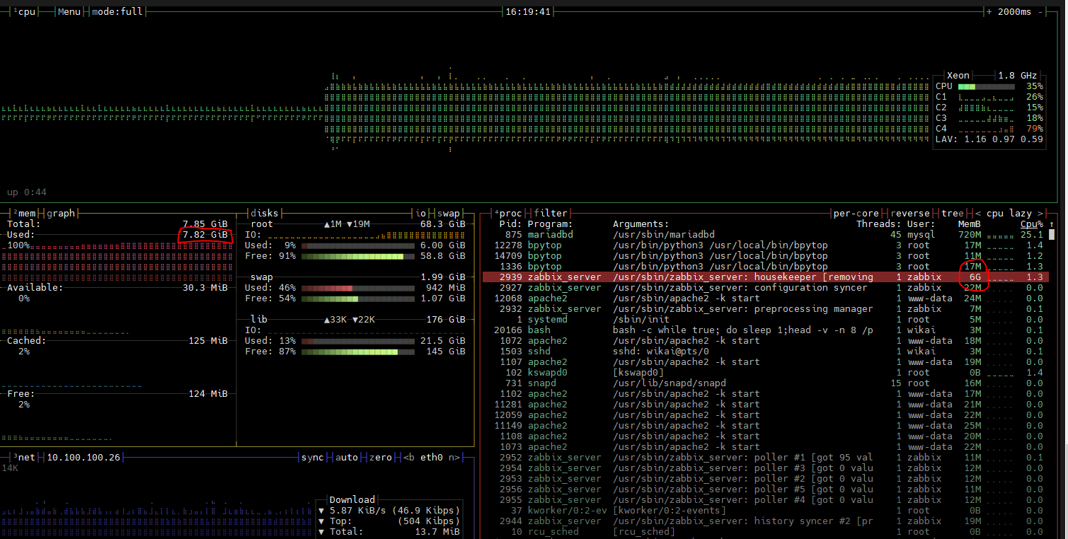

    After that, another problem came up: the Housekeeper process, which shoots up the RAM usage up to 100%, and makes the OS to kill zabbix-server process. If I leave the RAM dynamic for the VM, the consumption shoots up to 40-50 GB of RAM.
    As result, my graphs have spaces approx. every 30 min (please see the screenshots).

    RAM problem:
    Click image for larger version  Name:	RAM problem.png Views:	0 Size:	158.5 KB ID:	451486
