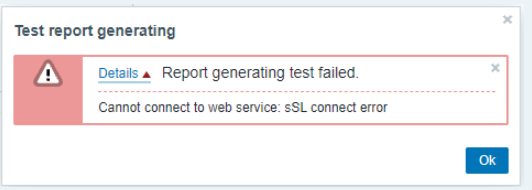

    My scheduled report was working beautifully until I configured SSL (on apache) for Zabbix that redirect all request HTTP to HTTPS. (Directions at the bottom).
    So, I reconfigured the server URL for the GUI (Administration->General->others) pointing to HTTPS:// instead of HTTP://, Then I changed the server configuration:
    /etc/zabbix/zabbix_server.conf
    + WebServiceURL=https://zabbix.ip:10053/report​
    /etc/zabbix/zabbix_web_service.conf
    +IgnoreURLCertErrors=1​
    But after restarting zabbix_services, and testing the scheduled report I got: "Cannot connect to web service: sSL connect error"
    Click image for larger version  Name:	image.png Views:	0 Size:	24.8 KB ID:	452089​
    Browsing for similar issues, I found several tickets with the problem but none of them was commented on or even resolved.
    I was giving up on SSL and started rollback, but I only returned the Zabbix server config to HTTP (and restarting zabbix server), nothing else was rolled back, yet that made the trick.
    + WebServiceURL=http://zabbix.ip:10053/report​
    So despite the apache server has SSL redirecting from HTTP to HTTPS, the scheduled report is working beautifully again.
