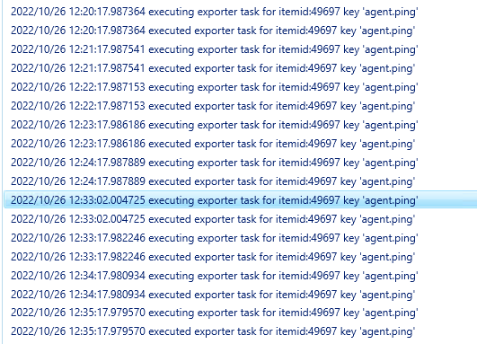

        I have attached a screenshot from the Agent Log. The Ping reported the Data each Minute then there is a pause from 9 minutes and then it is working again
        • Markku
          • Sep 2018
          • 1784
          It looks quite clear that the agent decides to not send the results for some time.
          The seconds are also remarkable: it always sends 17 seconds past full minute, except during the problem time.
          I don't have any explanation for this. Have you already reinstalled the agent? Is there any endpoint security software installed that maybe needs some adjustment?
