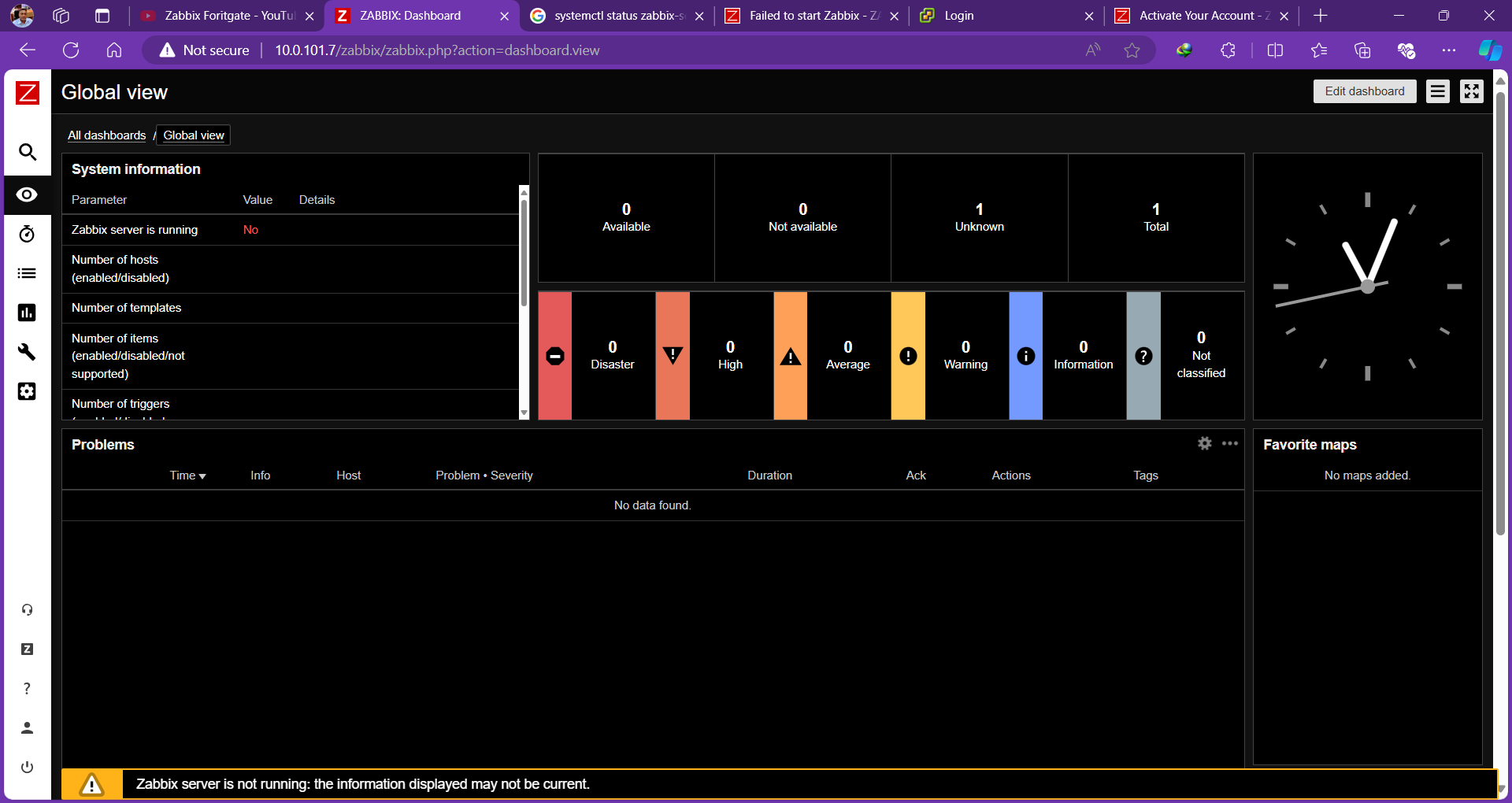

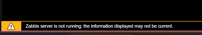

              completely installed Zabbix but Zabbix service does not start systemctl start zabbix-server.service
              Job for zabbix-server.service failed because the service did not take the steps required by its unit configuration.
              See "systemctl status zabbix-server.service" and "journalctl -xe" for details.
              here has page error
Name:	Screenshot 2024-07-11 105617.png

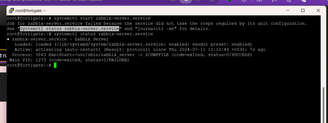

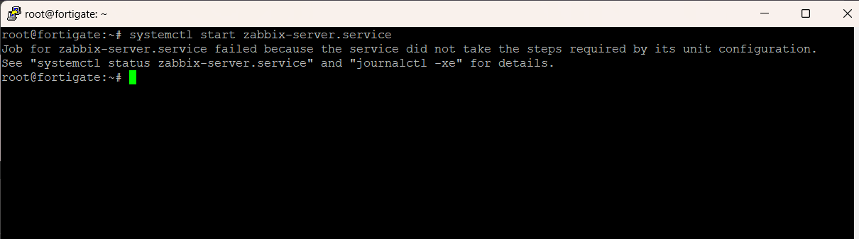

              • prasadeng
                • Jul 2024
                zabbix service not starting here has error systemctl start zabbix-server.service
                • prasadeng
                  • Jul 2024
                  here another screen shot
