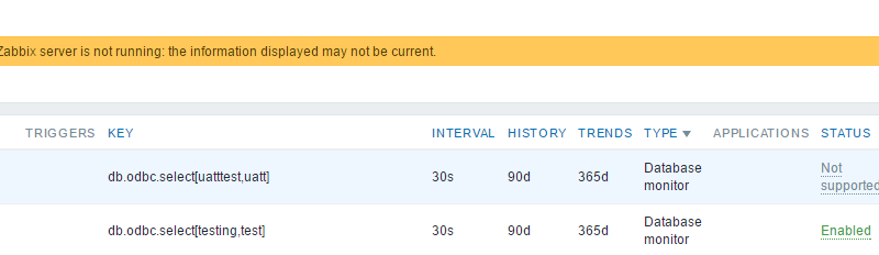

when i enable the database monitor "test", the warning will come out.
Where the database "test" is the zabbix's mysql database.
i can use isql to access the test
and i check the zabbix server log, it give out
What is the problem?
[root@localhost etc]# isql test +---------------------------------------+ | Connected! | | | | sql-statement | | help [tablename] | | quit | | | +---------------------------------------+ SQL> select count(*) from hosts +---------------------+ | count(*) | +---------------------+ | 42 | +---------------------+ SQLRowCount returns 1 1 rows fetched
3573:20160331:180629.103 Zabbix Server stopped. Zabbix 3.0.1 (revision 58734). 3617:20160331:180639.379 Starting Zabbix Server. Zabbix 3.0.1 (revision 58734). 3617:20160331:180639.379 ****** Enabled features ****** 3617:20160331:180639.379 SNMP monitoring: YES 3617:20160331:180639.379 IPMI monitoring: YES 3617:20160331:180639.379 Web monitoring: YES 3617:20160331:180639.379 VMware monitoring: YES 3617:20160331:180639.379 SMTP authentication: YES 3617:20160331:180639.379 Jabber notifications: YES 3617:20160331:180639.379 Ez Texting notifications: YES 3617:20160331:180639.379 ODBC: YES 3617:20160331:180639.379 SSH2 support: YES 3617:20160331:180639.379 IPv6 support: YES 3617:20160331:180639.379 TLS support: YES 3617:20160331:180639.379 ****************************** 3617:20160331:180639.379 using configuration file: /etc/zabbix/zabbix_server.conf 3617:20160331:180639.387 current database version (mandatory/optional): 03000000/03000000 3617:20160331:180639.387 required mandatory version: 03000000 3617:20160331:180639.395 server #0 started [main process] 3630:20160331:180639.401 server #13 started [trapper #5] 3632:20160331:180639.403 server #15 started [alerter #1] 3633:20160331:180639.403 server #16 started [housekeeper #1] 3635:20160331:180639.403 server #18 started [http poller #1] 3638:20160331:180639.404 server #21 started [history syncer #2] 3641:20160331:180639.404 server #24 started [escalator #1] 3642:20160331:180639.406 server #25 started [proxy poller #1] 3631:20160331:180639.408 server #14 started [icmp pinger #1] 3627:20160331:180639.409 server #10 started [trapper #2] 3640:20160331:180639.411 server #23 started [history syncer #4] 3622:20160331:180639.411 server #5 started [poller #3] 3623:20160331:180639.421 server #6 started [poller #4] 3643:20160331:180639.432 server #26 started [self-monitoring #1] 3619:20160331:180639.432 server #2 started [db watchdog #1] 3620:20160331:180639.432 server #3 started [poller #1] 3624:20160331:180639.443 server #7 started [poller #5] 3625:20160331:180639.453 server #8 started [unreachable poller #1] 3626:20160331:180639.464 server #9 started [trapper #1] 3629:20160331:180639.466 server #12 started [trapper #4] 3634:20160331:180639.468 server #17 started [timer #1] 3639:20160331:180639.479 server #22 started [history syncer #3] 3621:20160331:180639.480 server #4 started [poller #2] 3628:20160331:180639.490 server #11 started [trapper #3] 3618:20160331:180639.492 server #1 started [configuration syncer #1] 3637:20160331:180639.492 server #20 started [history syncer #1] 3636:20160331:180639.536 server #19 started [discoverer #1] 3620:20160331:180657.577 Got signal [signal:11(SIGSEGV),reason:1,refaddr:(nil)]. Crashing ... 3620:20160331:180657.577 ====== Fatal information: ====== 3620:20160331:180657.577 Program counter: 0x7f575fc10961 3620:20160331:180657.577 === Registers: === 3620:20160331:180657.577 r8 = 0 = 0 = 0 3620:20160331:180657.577 r9 = 7fff553b2cb0 = 140734623329456 = 140734623329456 3620:20160331:180657.577 r10 = 7fff553b2ae0 = 140734623328992 = 140734623328992 3620:20160331:180657.577 r11 = 7f576253d9e0 = 140013288544736 = 140013288544736 3620:20160331:180657.577 r12 = 7fff553b4180 = 140734623334784 = 140734623334784 3620:20160331:180657.577 r13 = 5fc2a421 = 1606591521 = 1606591521 3620:20160331:180657.577 r14 = 1139250 = 18059856 = 18059856 3620:20160331:180657.577 r15 = 1124f70 = 17977200 = 17977200 3620:20160331:180657.577 rdi = 0 = 0 = 0 3620:20160331:180657.577 rsi = 7f575fc2a421 = 140013245473825 = 140013245473825 3620:20160331:180657.577 rbp = 7fff553b2d50 = 140734623329616 = 140734623329616 3620:20160331:180657.577 rbx = 0 = 0 = 0 3620:20160331:180657.577 rdx = 0 = 0 = 0 3620:20160331:180657.577 rax = 0 = 0 = 0 3620:20160331:180657.577 rcx = 0 = 0 = 0 3620:20160331:180657.577 rsp = 7fff553b2d28 = 140734623329576 = 140734623329576 3620:20160331:180657.577 rip = 7f575fc10961 = 140013245368673 = 140013245368673 3620:20160331:180657.577 efl = 10283 = 66179 = 66179 3620:20160331:180657.577 csgsfs = 33 = 51 = 51 3620:20160331:180657.577 err = 4 = 4 = 4 3620:20160331:180657.577 trapno = e = 14 = 14 3620:20160331:180657.577 oldmask = 0 = 0 = 0 3620:20160331:180657.577 cr2 = 0 = 0 =
3620:20160331:180657.577 === Backtrace: === 3620:20160331:180657.578 18: /usr/sbin/zabbix_server: poller #1 [got 0 values in 0.000005 sec, getting values](print_fatal_info+0x287) [0x487d77] 3620:20160331:180657.578 17: /usr/sbin/zabbix_server: poller #1 [got 0 values in 0.000005 sec, getting values]() [0x488076] 3620:20160331:180657.578 16: /usr/lib64/libc.so.6(+0x35670) [0x7f575fae3670] 3620:20160331:180657.578 15: /usr/lib64/libc.so.6(+0x162961) [0x7f575fc10961] 3620:20160331:180657.578 14: /usr/lib64/mysql/libmysqlclient.so.18(my_strdup+0x18) [0x7f576253d9f8] 3620:20160331:180657.578 13: /usr/lib64/libmyodbc5a.so(myodbc_init+0xaa) [0x7f5750eead5a] 3620:20160331:180657.578 12: /usr/lib64/libmyodbc5a.so(my_SQLAllocEnv+0x24) [0x7f5750eee994] 3620:20160331:180657.578 11: /usr/lib64/libodbc.so.2(+0xd8dc) [0x7f5761cfa8dc] 3620:20160331:180657.578 10: /usr/lib64/libodbc.so.2(SQLConnect+0x1a7) [0x7f5761cfcaf7] 3620:20160331:180657.578 9: /usr/sbin/zabbix_server: poller #1 [got 0 values in 0.000005 sec, getting values](odbc_DBconnect+0x12a) [0x4bb8aa] 3620:20160331:180657.578 8: /usr/sbin/zabbix_server: poller #1 [got 0 values in 0.000005 sec, getting values](get_value_db+0x165) [0x434a65] 3620:20160331:180657.578 7: /usr/sbin/zabbix_server: poller #1 [got 0 values in 0.000005 sec, getting values]() [0x42baa3] 3620:20160331:180657.578 6: /usr/sbin/zabbix_server: poller #1 [got 0 values in 0.000005 sec, getting values](poller_thread+0x116) [0x42bc76] 3620:20160331:180657.578 5: /usr/sbin/zabbix_server: poller #1 [got 0 values in 0.000005 sec, getting values](zbx_thread_start+0x57) [0x488b27] 3620:20160331:180657.578 4: /usr/sbin/zabbix_server: poller #1 [got 0 values in 0.000005 sec, getting values](MAIN_ZABBIX_ENTRY+0x41d) [0x41da8d] 3620:20160331:180657.578 3: /usr/sbin/zabbix_server: poller #1 [got 0 values in 0.000005 sec, getting values](daemon_start+0x1da) [0x4872da] 3620:20160331:180657.579 2: /usr/sbin/zabbix_server: poller #1 [got 0 values in 0.000005 sec, getting values](main+0x39f) [0x41812f] 3620:20160331:180657.579 1: /usr/lib64/libc.so.6(__libc_start_main+0xf5) [0x7f575facfb15] 3620:20160331:180657.579 0: /usr/sbin/zabbix_server: poller #1 [got 0 values in 0.000005 sec, getting values]() [0x4183e5]
