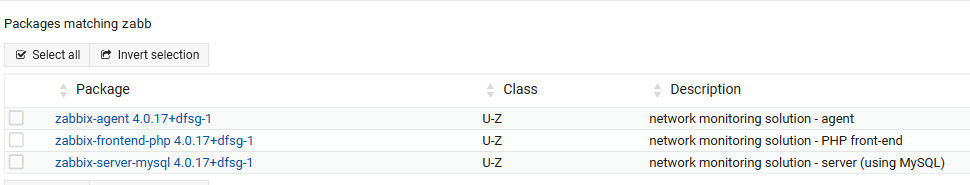

    ​2. setup fails think database is at version 40000000
    re: "The Zabbix database version does not match current requirements. Your database version: 4000000. Required version: 6000000."
    3. even though the download is ver 6.0, it installs version 4
    [Click and drag to move]
    I have purged the install files, when so far as to manually delete the /etc/zabbix /usr/share/zabbix*. deleted the /etc/apt/source.list.d/ zabbix* and reinstall .deb package.
    Could the .deb file be referring to the wrong binaries ie: v4 instead of v6?
    Any ideas?​​

    I have been able to resolve this issue. .deb package did not update the files in the /etc/apt/sources.list.d directory.
    ie: I manually deleted the following and reinstalled the deb package.
    zabbix-agent2-plugins.list.save
    zabbix.list.distUpgrade
    zabbix.list.save​
    They were referencing ver 4 and 5 of zabbix. That's why the install was installing older versions. If the programmers are reading, maybe the deb package will force delete any references of zabbix sources and install fresh links.
