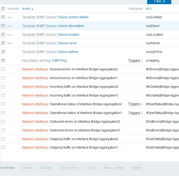

    • thensel
      • Jun 2012
      I want to disable triggers/items ob one specific host.
      Yes, there is a button "disable". But the checkboxes at the items are inactive so I cannot check them.
      I have added a screenshot so you can see the inactive checkboxes at the items created by lld
      • unficyp
        • Dec 2014
        • 27
        Oh sorry, i over read the LLD.
        Since you can disable them by hand on the right side clicking "Enabled" but not with mass update, i guess this is a bug.
