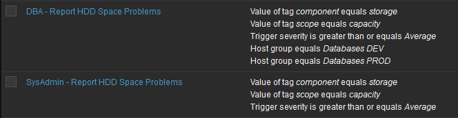

    I have two Trigger Actions for reporting HDD space issues. One of them is restricted by Host Group. The SysAdmin - Report HDD Space Problems works but the DBA - Report HDD Space Problems does not. Am I not allowed to have two trigger actions based on the same tags or something? Why would this DBA trigger action not work? There are no failures on the problem that it wasn't able to send or anything. It just shows the successful send from the SysAdmin trigger action.

                I have the configs in the first post but I did update them slightly and here are some additional screen shots:
                SA Alerts:
                DBA alerts:
                Essentially these alerts do the exact same thing except one is filtered by two host groups. The SA alerts should be triggering all the same alerts that get triggered by the DBA alerts since the SA alerts trigger encompasses all hosts. However, when I get alerts from the DBA alerts the SA alerts do not send. If I disable the DBA alerts then the SA alerts start working.
                I believe this is a bug in how the trigger actions are filtering the host groups as I can produce very strange behavior but playing around with what host groups are or are not filtered.
                Additionally I can do something like disabled the DBA alerts, clone the SA alerts and produce duplicate alerts. So the two SA alerts will fire at the same time. But if I add a host group filter to the cloned SA alerts then things start breaking.
                Essentially the only way I can consistently get this to work is to make sure there are no overlapping hosts if host group filters are applied. So if I add a host group filter to the DBA alerts then I need to add a host group filter to the SA alerts as well. However, there is a issue with this as well because the Host group does not equal filter seems to do the opposite in the scenario. If I add Host group does not equal Database Prod to the SA alerts then I start getting duplicate alerts. One from DBA and one from SA even though the SA alert says Does NOT equal.​
