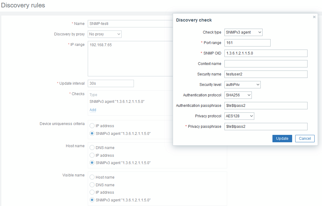

    Moi, seems to work here just fine, on 6.0.11 and 6.4.0beta5.
    I was testing with these:
    Was there a specific reason you think the password was the reason for the discovery to not work?

      Ok I didn't see your edit earlier. Make sure you are using the correct OID in the discovery (like 1.3.6.1.2.1.1.5.0).
