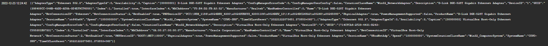

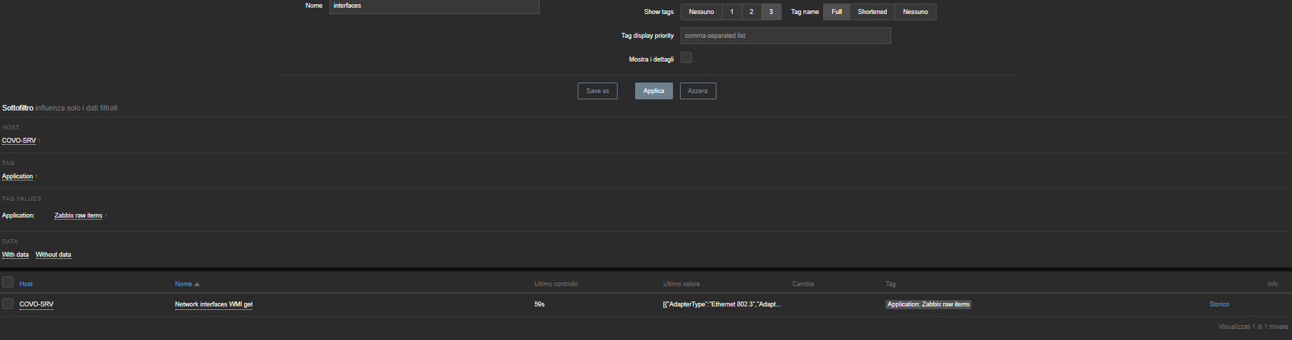

    I have an issue with AGENT 2 (ver. 6.0.5) in W2019 and active checks enabled.
    I noticed that network interfaces are not discovered but the wmi query (under application:raw) is performed correctly.
    Maybe some configuration error, but I need support to find it.
