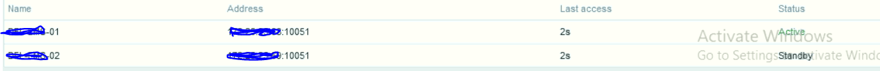

                      scenario 1: as shown in above snap ,I am able to open the GUI using servre-01 IP i.e. the Active one.

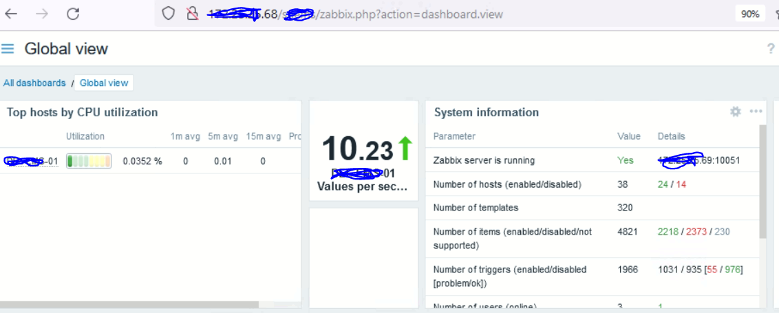

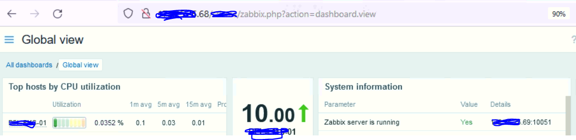

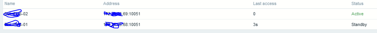

                          Now when failover happen and​ server-02[XX.XX.XX.69] becomes active as shown below in snap1 then I can open the frontend using xx.xx.xx.68 ip and not by using XX.XX.XX.69.

                          Snap for frontend.(snap-2)

                          Now in above pic we can see the zabbix server is running on XX.XX.XX.69 but we can access the frontend using XX.XX.XX.68 only​ so is this the correct as per architecture or not just,want to confirm only.

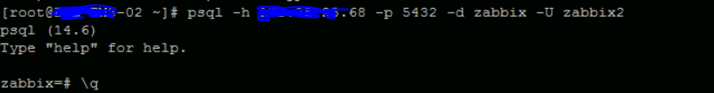

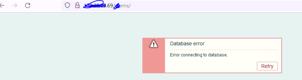

                              Please see below error but I can connect to db server from 69 using CLI.

                              Frontend error
