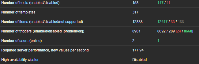

    I have install new Zabbix server + 1x Zabbix Proxy.
    The server is running for 2 weeks, and i have reach to the point the log creating "slow query", if I got it right, its related when the server is not powerful enough to get the information from DB.
    I guess this is why i am also having very slow reaction in the web-gui, and also miss some information in graphs.
    The server is running on Ubuntu Server 22 \ VM Machine \ 2VCPU \ 24 RAM.
    Any suggestion where is my bottle neck? do i need better server? The idea eventually is to monitor ~1500 different devices (agent\snmp)
    Thank you

    • galavichid
      • Mar 2021
      • 45
      Lerma how many hosts/triggers/items you monitor? What are the specs of your machine?
      i have made big change and remove from discovery the “services discovery” and deleted all these items, then run a housekeeping to clean it all and it’s running much faster now.
      it’s just a work around for now till I get it set with dedicated server in production.
      i guess as Hamardaban says, must use a good server and configure it right.
      thank you

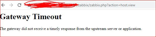

    • Lerma
      • Aug 2022
      • 7
      galavichid CPU Core i3. 2.90 GHZ, RAM 8GB, 64 bits
      OS: CENTOS 9,
      When I click on the hosts option in the DASHBOARD tab, Front End becomes slow until Gateway timeOut appears
