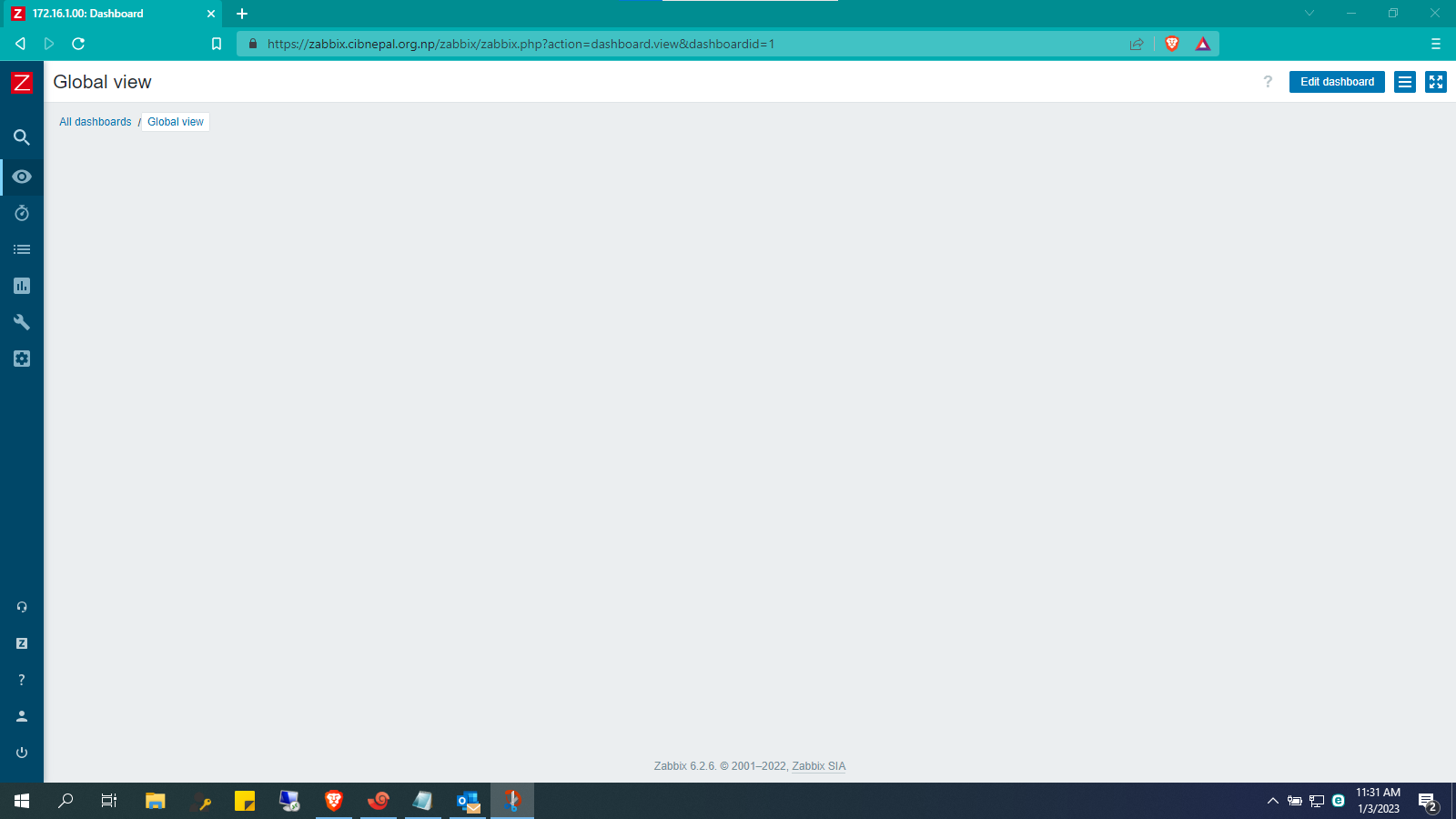

    Recently installed zabbix 6.2, at first global view, zabbix server health and zabbix server all were displaying information but somebody changed the configuration and after that I am not able to view dashboards, whenever I go to create new dashboard creation blank screen appears and no option to add widgets is shown

    Maybe you ask that "somebody" to give back rights to see that "global view" dashboard? Or at least say what was done and why and what should you do now..:P

      This is the error shown on apache error log
      PHP Fatal error: Uncaught Error: Failed opening required '/usr/share/zabbix/include/config.inc.php' (include_path='.:/usr/share/php') in /usr/share/zabbix/zabbix.php:22\nStack trace:\n#0 {main}\n thrown in /usr/share/zabbix/zabbx.php on line 22

        Solved,
        Issue was LimitRequestLine 10240 in apache2.conf was decreased to 500 only during server hardening, checked my documentation during hardening and decreased the value
