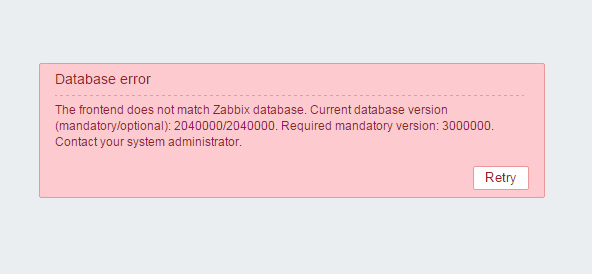

    Hey,
    I`m try to backup and restore Zabbix 2.4.7 to Zabbix 3.0.1.
    after backup zabbix DB, and restore DB to new server i got error:
    Database error
    The frontend does not match Zabbix database. Current database version (mandatory/optional): 2050001/2050001. Required mandatory version: 3000000. Contact your system administrator.
    In Log file i see:
    current database version (mandatory/optional): 02050001/02050001
    required mandatory version: 03000000
    starting automatic database upgrade
    [Z3005] query failed: [1060] Duplicate column name 'lastlogsize' [alter table proxy_history add lastlogsize bigint unsigned default '0' not null]
    database upgrade failed
    restart MYSQL,ZABBIX and server not help ,
    can anyone know how to solve this ?

    I got the same issue on one of my Zabbix proxies.
    My frontend database upgrade was successful, but that was going from centos 6 to centos 7 and then importing the database.
    This proxy scenario, I am attempting to get a Centos 6.x to run Zabbix 3.0.3.
    Mysql - 5.1.73.
    I might just purge the DB since its a proxy..
