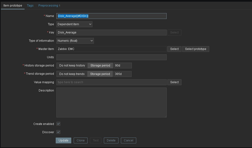

            • bab
              • Aug 2020
              • 197
              Originally posted by cyber
              So I assume your item works and retrieves data? Add a preprocessing to it, "CSV to JSON". then your data is saved as
              Add a discovery. Type of information -> text. Set its type as "dependent item" and point master item to the item that retrieves your data. Add to LLD macros tab "{#DISK} -> $.disk".
              Add item prototype to discovery, Type of information -> float. Set its type as "dependent item" and point master item to the item that retrieves your data. (yes the same as in discovery). Add preprocessing "JSONPath -> $.[?(@.disk=="{#DISK}")].['Average Response Time us'].first()"
              EDIT2: name your item prototype as disk_avgerage[{#DISK}] for example... it has to contain LLD macro, but rest is up to you...
              Now, when your main item acquires data, first time all the items are created, based on disk name. Second time, they are already populated with a value.
              ​EDIT: oh short answer came earlier..
              I have created an item on my server with userparameter such as attach pic 11.jpg and it is returns follow output :

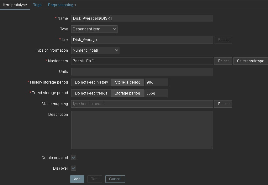

              In the next step I have created a discover rule with attached item.prototype and preprocessing but when I click on test it shows error . How can solve it ?

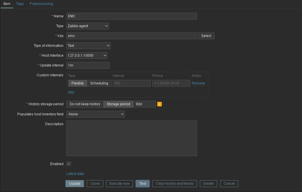

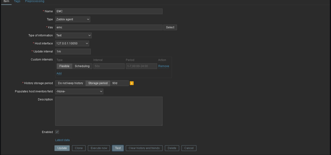

                  At the first step I have created an item such as emc1.jpg that returns follow output :
                  HTML Code:
                  Timestamp,SP,disk,Average Response Time us
                  2023-01-19 21:45:20,spa,dae_0_1_disk_0,22.62
                  2023-01-19 21:45:20,spa,dae_0_1_disk_10,49368
                  2023-01-19 21:45:20,spa,dae_0_1_disk_12,20.83
                  2023-01-19 21:45:20,spa,dae_0_1_disk_14,19.21
                  2023-01-19 21:45:20,spa,dae_0_1_disk_16,12239
                  2023-01-19 21:45:20,spa,dae_0_1_disk_18,49557
                  2023-01-19 21:45:20,spa,dae_0_1_disk_2,12074
                  2023-01-19 21:45:20,spa,dae_0_1_disk_20,21.17
                  2023-01-19 21:45:20,spa,dae_0_1_disk_22,8135​

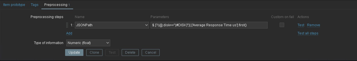

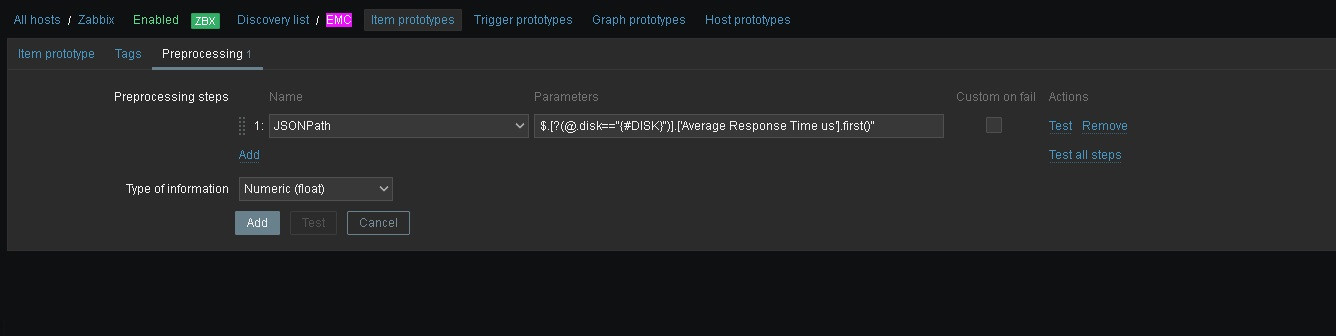

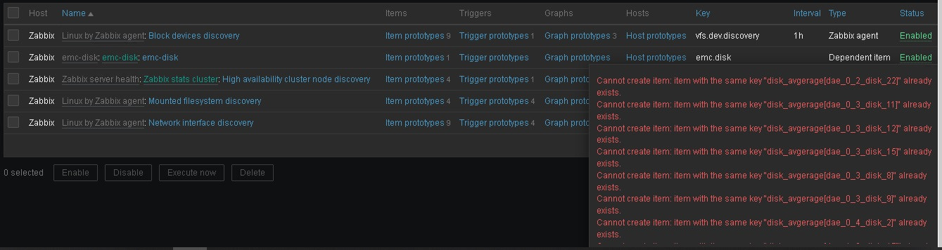

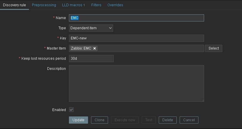

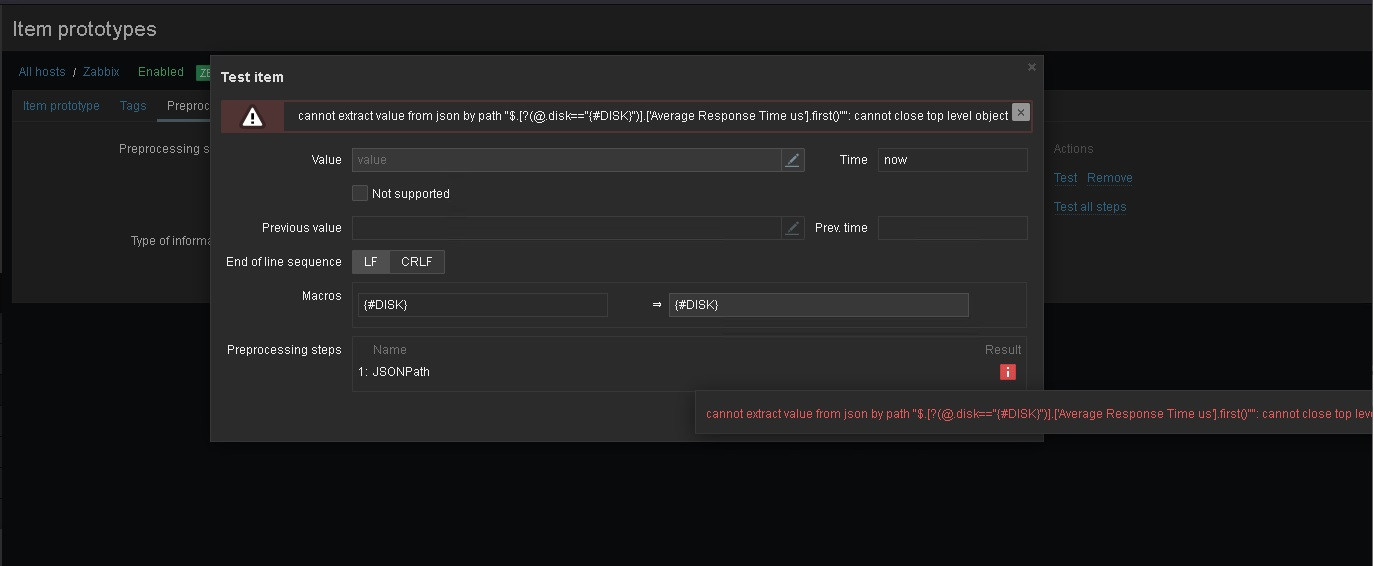

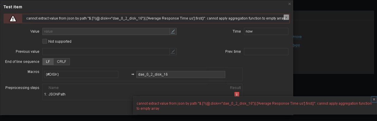

                  in the next step I have created an itemprototype such as emc3.jpg with preprocessing emc4.jpg

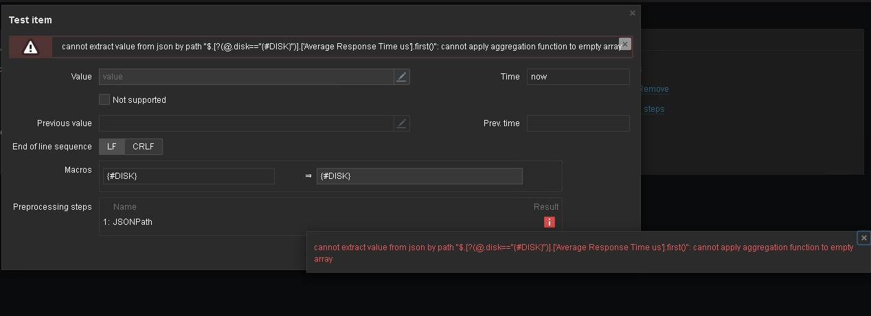

                  now when click on test it shows error (emc5.jpg)
                  Also I gave value to macro but returns error (emc6.jpg)
                  What is the issue ?
                    What is the issue ?
                      • 4971
                      Did you enter something into "value" filed also, when testing?
                      I cannot find from pics, where do you apply "csv to json" preprocessing? emc1.jpg does not have any preprocessing steps...

                        According to emc6.jpg I just insert parameter in macro part for test
                        I used CSV to json according emc4.jpg in item prototype in discovery
                          • 4971
                          That pic show only jsonpath preprocessing, but no "csv to json", please add it to the item on pic emc1.jpg....
                          And if you test, you need to give also starting data to test, not just one value to macro...
