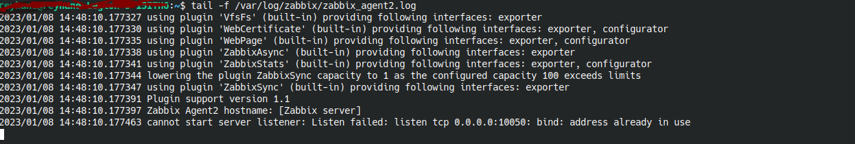

    these are my zabbix-server and zabbix-agent2 logs:
  • reyhane
    • Jan 2023
    • 12
    SOLVED!
    Apparently agent2 wasn't running because port 10050 was using by agent.
    So I removed (and for ensuring,purge) zabbix and installed it without zabbix-agent.
    It is fixed.
