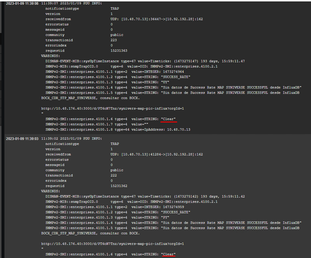

    Carrying out different tests, we see that having more than one problem alarm simultaneously (for example 3), they arrive correctly to snmptrap (log in /var/log/zabbix_traps.tmp) and then the script is executed with the data of the corresponding alerts. Until here the circuit works correctly. The problem lies when the OKs are established. When solving those 3 "problems" of the detailed example, We verify that the traps arrive correctly to the snmptrap (/var/log/zabbix_traps.tmp), but when the return of the zabbix is ​​established so that the script with the resolutions is then executed and sent to the Temip server, we find the following:​

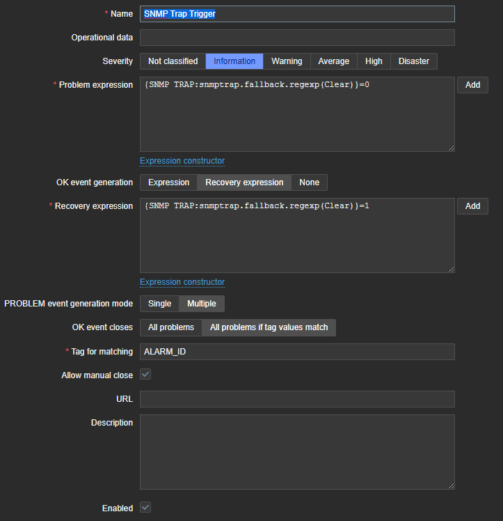

    When we send 2 alarms simultaneously or more, the tag that is configured in the trigger, only resolves to "OK" the last event and not the ones that precede it. We believe that this may have to do with the definition of the tagID.
    See the capture latest-data.png​
    you can see that it solves correctly because the clear is the recovery expression

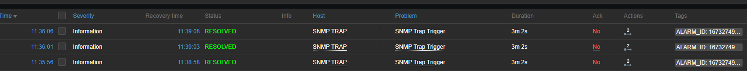

    See the capture problems-resolved.png​

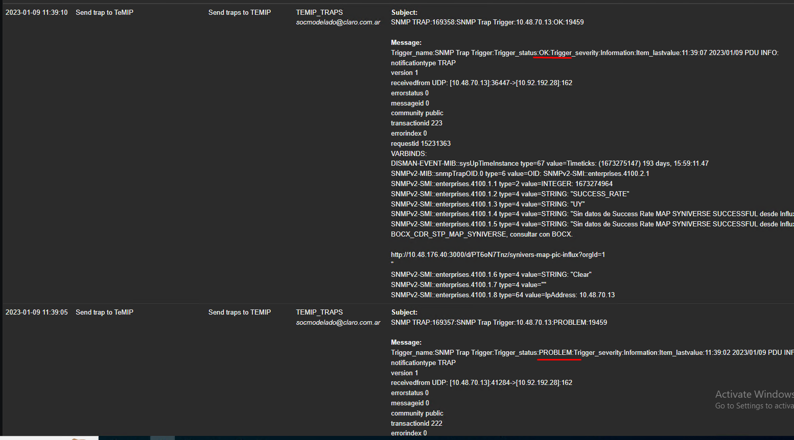

    This is the output of the action log, after it is resolved and run the script
    See the capture action-log.png​
    Here you can see how the last event is with status ok, but the previous one with problem, when it should have been
    result with ok.
    TAG_ID to resolve multiple trouble events with OK
    {{ITEM.LASTVALUE}.regsub("(?<=enterprises.4100.1.1 type=2 value=INTEGER: )[\w+.-]+", \0)}
    Could the problem be here?
