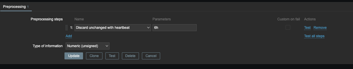

    Zabbix 6.2.4 holes in graphics when using SNMP
    hi
    Not correctly polled SNMP and IPMI. there are holes in the graphics
    Zabbix 6.2.6
    Ubuntu 20.04
    Timeout=4
    ​UnreachablePeriod=45
    UnavailableDelay=60
    UnreachableDelay=15
    tolal SNMP IPMI hosts 30
    ​I don't know what can be done. help me plz

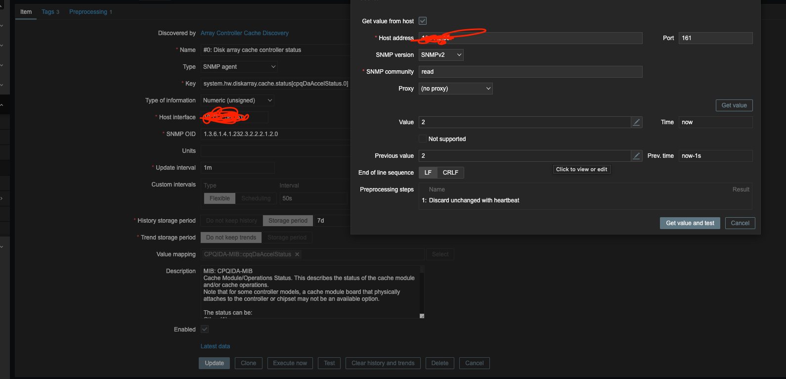

        • emaus
          • Jun 2021
          • 9
          did not quite understand the question)
          if you restart the service, all graphs are drawn normally, but then the data disappears
          but some charts work fine
Name:	Снимок экрана 2023-01-15 в 21.18.57.png
            • 4996
            Originally posted by Markku
            What is the preprocessing step configured for the item?
            Markku
            There's "discard unchanged with heartbeat"... visible on pic in first answer...
            • Markku
              • Sep 2018
              • 1784
              Right, missed that from the picture.
              So emaus, if you want continuous graphs, start with removing the preprosessing rule that discards data.
              Markku

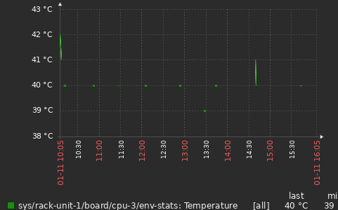

              • emaus
                • Jun 2021
                • 9
                Removed from template "discard unchanged with heartbeat" and everything worked out
                thanks everyone))
