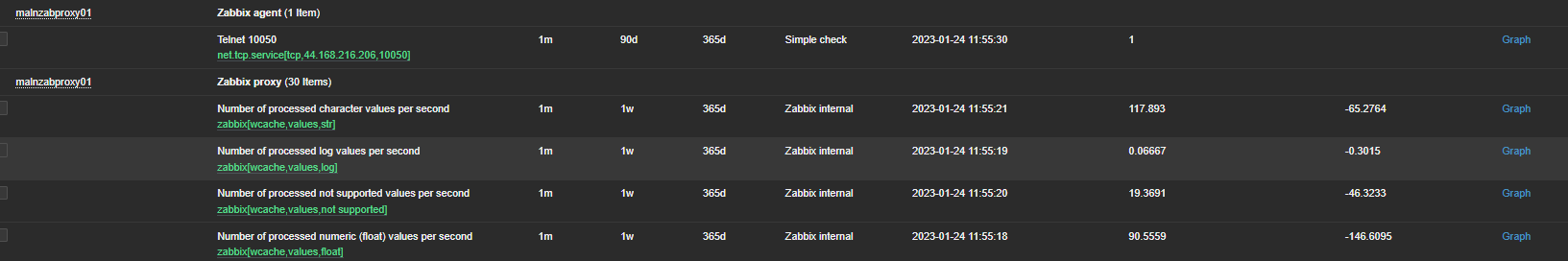

          Apart from that, I've realized that all item monitoring with the type external check, simple check or zabbix internal, work ok.

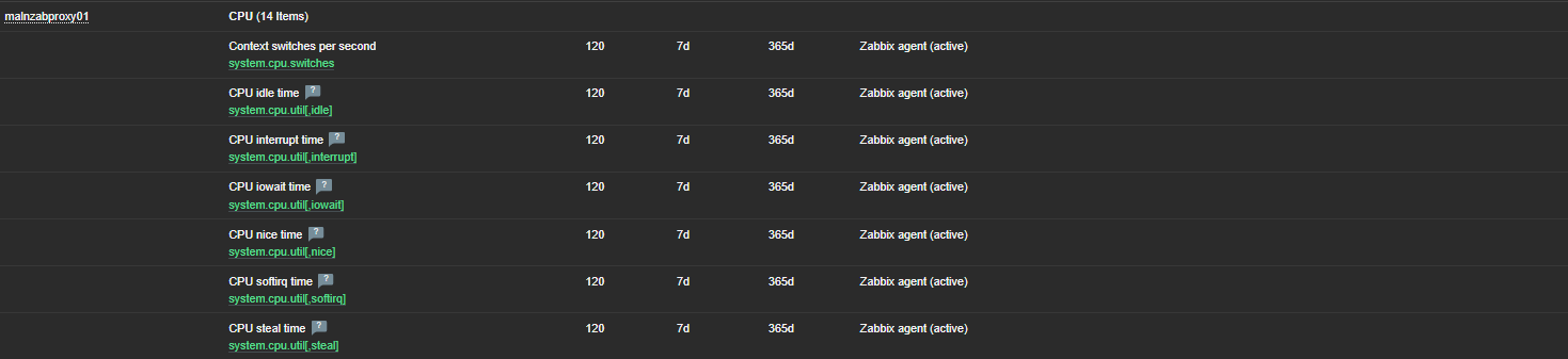

          What it doesn't work are the items monitorized with the type zabbix agent active.
