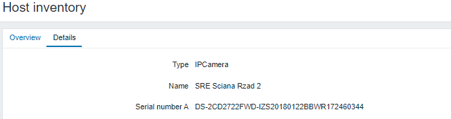

    I'm on zabbix 6.2 version and according to this page https://www.zabbix.com/documentation...ed_by_location {INVENTORY.NAME} is supported in Trigger-based notifications and commands.
    My setup:
    using built in template for hikvision cameras i added discover rule to find all cameras, then set up action to add them to hosts and set their inventory mode to automatic. When i go to inventory page for any camera then name field is populated by template item key hikvision_cam.device_name so thats work.
    Now i want to setup basic trigger.
    The {HOST.HOST} part translate correctly to camera ip, but inventory.name does not while it has Name in inventory
