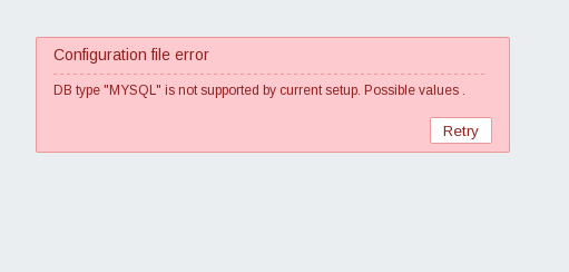

Zabbix 3.0 DB type "MYSQL" is not supported by current setup. Possible values .
  • anishkvmca
    • Apr 2016
    • 13
    Installed zabbix-3.0.1.tar.gz successfully on RHEL 6
    Zabbiz front end php package configured.
    When opening in browser : Configuration file error
    Mysql is configured properly and all grant privileges added to zabbix.

    So .. how did you install zabbix on this box?
    • anishkvmca
      • Apr 2016
      • 13
      Thank you for the reply.
      I've installed Zaabix from source "zabbix-3.0.1.tar.gz" and followed "4 Installation from sources" steps.
      I believe Zabbix is running as daemon in backend.
      But the problem is only associated with front end PHP and MySQL configuration.
      It might be a defect :-)
      location of 4 zabbix.conf.php is /var/www/html/zabbix/conf
      Also no MYSQL connectivity Errors from zabbix_server.log.
      I hope you can help me to figured out
      • kloczek
        • Jun 2006
        • 1771
        1st: check zabbix server log do you see in first few lines logged information that this binary has compiled in mysql support.
        2nd: as this error message is shown within web frontend and I don't see on the list of your php packages php-mysql probably this is causing your error message.
        3rd: on list of installed php packages there is no php-xml so you will be not able ti import/export templates. I don't see php-gd so you will have problems with displaying all graphs/maps.
                      Please review ldd output thanks
                      • anishkvmca
                        • Apr 2016
                        • 13
                        I've installed same Zabbix version 3.0 in CentOS6.7 box also with Mysql 5.6 and PHP 5.5.
                        There also getting same Error " Zabbix 3.0 DB type "MYSQL" is not supported by current setup. Possible values" while opening from browser localhost/zabbix
                        For debugging purpose I've removed /etc/httpd/html/zabbix/conf/zabbix.conf removed and then loading setup page. But in zabbix setup page "PHP Database Support" for MySQL is "failed" status.
                        Rest of all dependencies are passing successfully and only issue with this MySQL.
                        /tmp/zabbix_server.log also free from errors.
                        Someone from Zabbix please advise Why zabbix is mess sup with MySQL ?
                          Above has nothing to do with zabbix server so checking zabbix_server.log is pointless.
                          If you have installed php with proper set of extensions installed on checking phpinfo() over command like
                          $ php -r "phpinfo();" 2>/dev/null | egrep -i ^mysql | grep Support
                          You should see in output:
                          MySQL Support => enabled
                          MysqlI Support => enabled
                          • anishkvmca
                            • Apr 2016
                            • 13
                            Thank you very much for your valuable guidelines and resolved the issue.
                            I've installed all PHP packages and reinstalled again.
                            That errors resolved and new error from cat /etc/httpd/logs/error_log :
                            [Fri May 06 16:20:49 2016] [notice] suEXEC mechanism enabled (wrapper: /usr/sbin/suexec)
                            [Fri May 06 16:20:49 2016] [notice] Digest: generating secret for digest authentication ...
                            [Fri May 06 16:20:49 2016] [notice] Digest: done
                            [Fri May 06 16:20:49 2016] [notice] Apache/2.2.15 (Unix) DAV/2 PHP/5.3.3 configured -- resuming normal operations
                            [Fri May 06 16:20:52 2016] [error] [client 127.0.0.1] PHP Parse error: syntax error, unexpected '[' in /var/www/html/zabbix/index.php on line 29
                            [Fri May 06 16:20:53 2016] [error] [client 127.0.0.1] PHP Parse error: syntax error, unexpected '[' in /var/www/html/zabbix/index.php on line 29
                            Please advise ?
                            • Atsushi
                              • Aug 2013
                              • 2028
                              #15
                              PHP 5.4 or later is required for Zabbix 3.0 frontend.
                              PHP 5.3.3 does not work with.
