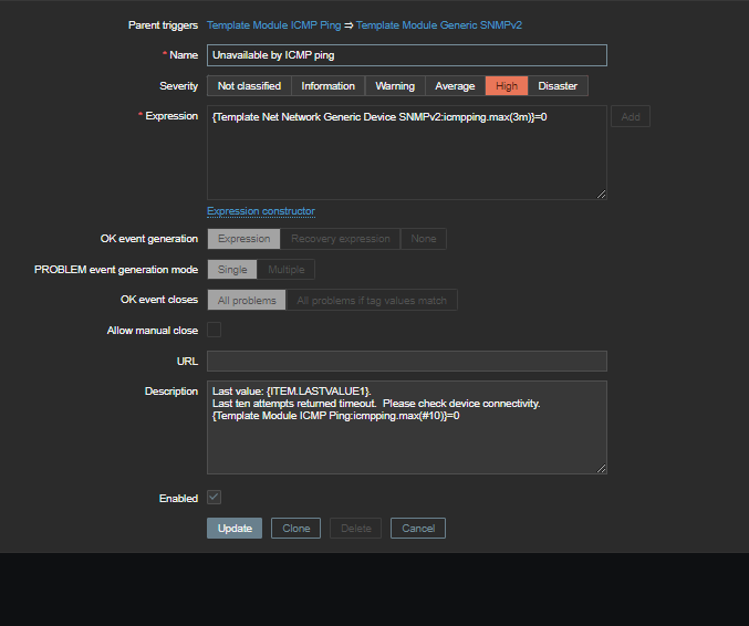

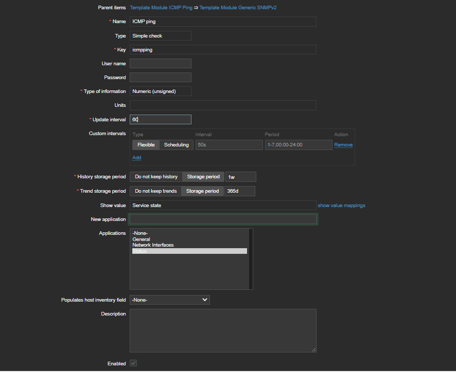

            this is how my items and trigers page looks like. Am I lookig at the right place?​

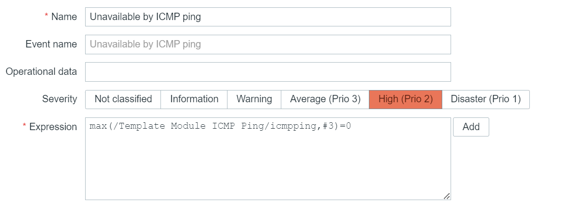

              Yes you are looking in correct places. I notice your trigger expression looks weird compared to mine, not sure if you are using correct syntax for that (why using curly brackets?), have a look at my trigger expression.
              Also on the item page include time unit in update interval (so for one minute type "1m" or "60s" in there. Let me know if that helped!​
