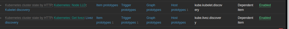

    i'm trying to configure the "kubernetes state by http" template on Zabbix 6.0.5, but at this time, i can collect only few metrics due to following error in many discovery rules:
    "Preprocessing failed for: {"error":"Error: cannot get URL: Couldn't connect to server."}
    1. Failed: cannot convert Prometheus data to JSON: data parsing error at row 1 "{"error":"Error: cannot get URL: Couldn't connect ...": cannot parse metric name"​
    I edited the 2 following macros in the host configuration and the same values are working properly on y with the kubernetes nodes by http template ( the macro for api endpoint is named "KUBE.API.ENDPOINT.URL in this one ):

    It's quite weird because other discovery rules properly works for the same template:

    What am i missing?
    How can i see further details regarding this error?
