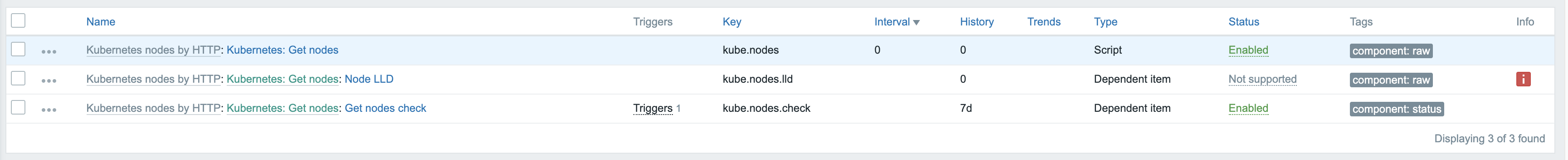

    Hi everyone,
    there is a problem with Kubernetes Nodes by HTTP template, Node.LLD has "Not Supported" status:
    The error is:
    Preprocessing failed for: {"error":"Request failed with status code 401: {"kind":"Status","apiVersion":"v1","met ad ...
    1. Failed: Discovery error: TypeError: cannot read property 1 of null.

      Sorry, I posted the wrong error message.
      The correct one is:
      Preprocessing failed for: {"kind":"NodeList","apiVersion":"v1","metadata" :{" resourceVersion":"38159554"},"items":[{"metadat...
      • jakub.imbrzykowski
        • Feb 2023
        Hi, i have the same issue but with other cloud provider.
        The reason of this is not having a port number in {$KUBE.API.ENDPOINT.URL}, proper API URL should match pattern in description.
        Regex in Node LLD script is jut required it.
        api_url = '{$KUBE.API.ENDPOINT.URL}',
        hostname = api_url.match(/\/\/(.+):/);​
        Unfortunately for me, after fix that i have next error "Discovery error: TypeError: unexpected type.".
        My Kubernetes API dose not returns "endpointIPs" field in JSON response...
        if (internalIP in input.endpointIPs) {
        Good luck!

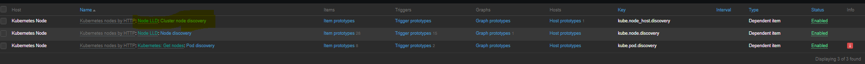

            Hello @jakub.imbrzykowsk/@​wooch ​ I have installed zabbix kube monitoring helm chart on AKS cluster and set macros correctly. I am receiving data for kubelet discovery: Kubernetes Kubelet by HTTP Template. However, Kubernetes nodes by HTTP: Node LLD: Cluster node discovery not working. It's unable to create additional host and attach “Linux by Zabbix Agent” template to it. Can you please provide suggestions?
            Note: Master Item "Kubernetes: Get node" is extracting the JSON payload. However, Node LLD item preprocessing returns error as "Discovery error: SyntaxError: invalid json (at offset 1)"
            Details:
            Version: zabbix 6.0
            Macros:
            {$KUBE.API.TOKEN}
            {$KUBE.NODES.ENDPOINT.NAME}​
