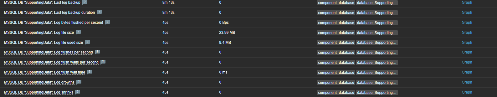

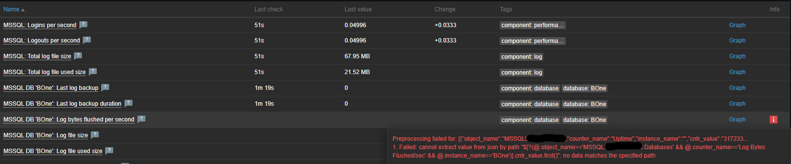

    I am trying to monitor our MSSQL database server. After figure out the guide and how to connect the with ODBC and everything, i get an error with preprocessing just on part of the db's.
    I tried on 2 different server's but i get same results. I do get other information or part of the DB's when looking @ Latest Data, which is strange. I think all the setting are right if I can get part of the info.
    I found one old thread about the same issue, which led me to this bug: https://support.zabbix.com/browse/ZBX-18554
    It looks like the same issue, but i have it on just part of the data, which is strange.
