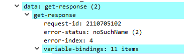

        So I disabled Bulk requests and that appears to have resolved it but for all the wrong reasons, I think there is an issue with the bulk processing. It seems as though if a single OID returns an error the entire bulk request is considered errored. I was able to locate a get-response in a pcap that showed the error but it only shows the error for a single OID out of 11 but ALL of them are marked as noSuchName in zabbix. Definitely incorrect behavior.
        the old server (5.0) used bulk requests and did NOT have this problem. Is there a setting I can tweak somewhere for this or is this a change in code?
