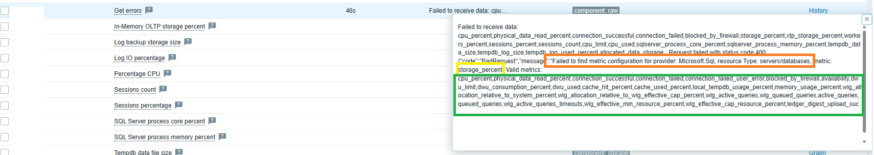

                  I know where the issue is. Zabbix is not being able to differentiate one Azure MSSQL database from another. Simply there are few types of MS SQL available, and each is accepting different API calls, rarely supporting the same API calls globally.
                  So, from the Monitoring > Latest Data > Pick appropriate AZ SQL/DB host > near "Get Error", users can click on the "Failed to receive data" info and expand it.
                  Orange indicates the problem
                  Yellow shows unsupported API call
                  Green shows supported options

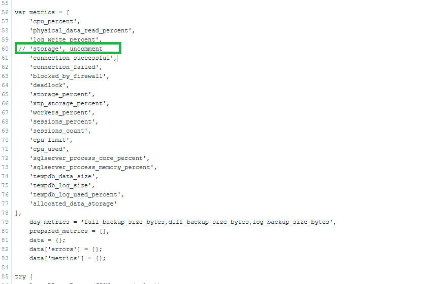

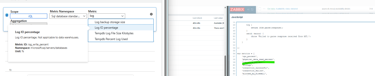

                  Go to Template > Items > Hit on Get Data and edit the script. Then either uncomment or replace the API with supported one, each time the output of the "Get errors" will be different now. All supported calls can be found in MS dosc or at Azure from resource level by going to Metrics.
