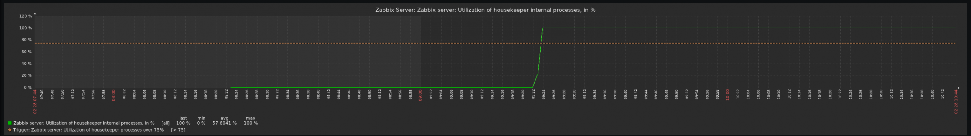

        Our housekeeping frequency is set to "1" (run each hour) and should clean up 5000 items. These 5K Items in my opinion won't do it. We gather 2.5K items every minute meaning our database will keep growing. Sadly the housekeeper can't finish this task it seems like. Click image for larger version
ID:	460160​Waiting nearly 90 minutes for only 5k items to be removed seems not right. CPU usage is still relatively high but the zabbix housekeeper process does not seems take advantage of this free cpu space. It sits idle with 0% Usage. Click image for larger version
        Because this housekeeper is not really delivering actual work during this test, I cannot tell if the delay is being caused by the housekeeper. What I can say is that after configuration of the db syncers no delays were found. (but as I said, housekeeper is not really working so keep that in mind). During this time 3 users have been online so the delay is probably not linked to the user count (for now).
