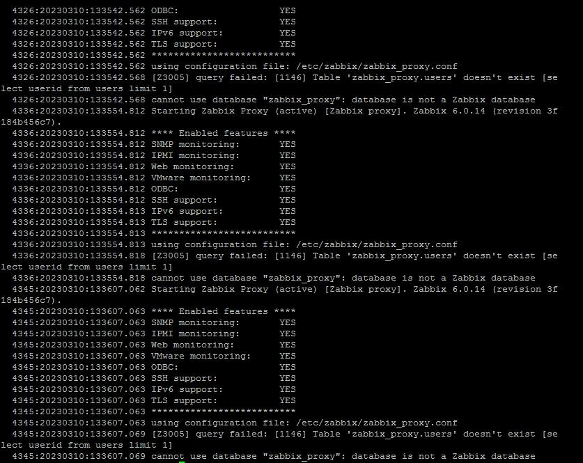

    hi,
    I installed Zabbix 6.0 (proxy) on CentOS7 but it gives an error.
    ERROR: "Job for zabbix-proxy.service failed because the control process exited with error code. See "systemctl status zabbix-proxy.service" and "journalctl -xe" for details."
    The log file screenshot is also attached.
    what solution do you suggest?​
    • 4996
    Fix your proxy DB issues...
    What kind of DB you configured there? SQLite3? Mysql? Seems like mysql? Sqlite3 will create a db file if it is not present...
    1240:20230215:143820.824 using configuration file: zabbix_proxy.conf
    1240:20230215:143820.830 cannot open database file "proxy.db": [2] No such file or directory
    1240:20230215:143820.830 creating database ...
    1240:20230215:143822.042 current database version (mandatory/optional): 06000000/06000018
    For mysql you may need to create schema by yourself...
    • mah
      • Mar 2023
      • 13
      Mysql configured. I also import the schema with command "cat /usr/share/zabbix-sql-scripts/mysql/proxy.sql | mysql --default-character-set=utf8mb4 -uzabbix -p zabbix_proxy"
