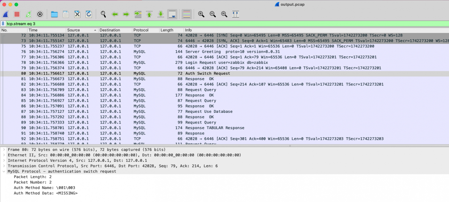

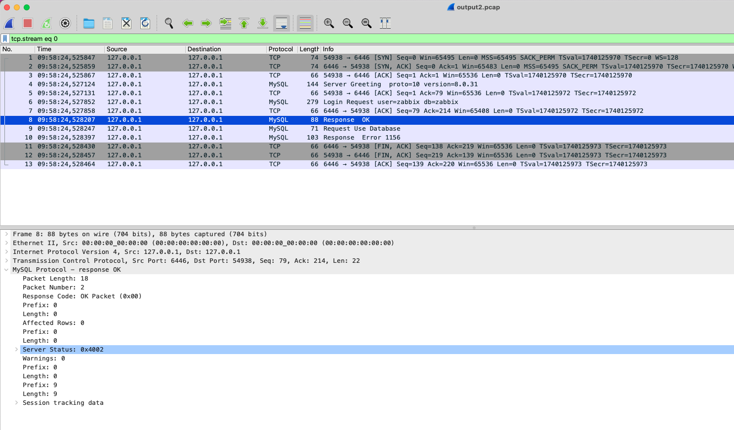

    Hello Dougpss, I have the same installation and the same issue ...
    Based on your and my test, I confirm that the issue is related to mysql-router 8.0.31 version
    I've performed a Wireshark trace on the loopback address, you can see an authentication behavior difference between 8.0.31 et 8.0.32 version:​
    • on 8.0.32 (with the connection issue):
    • on 8.0.31, no issue:
    There is an additional packet (n°80 - Auth Switch Request) visible. This behavior difference makes the issue I guess.
