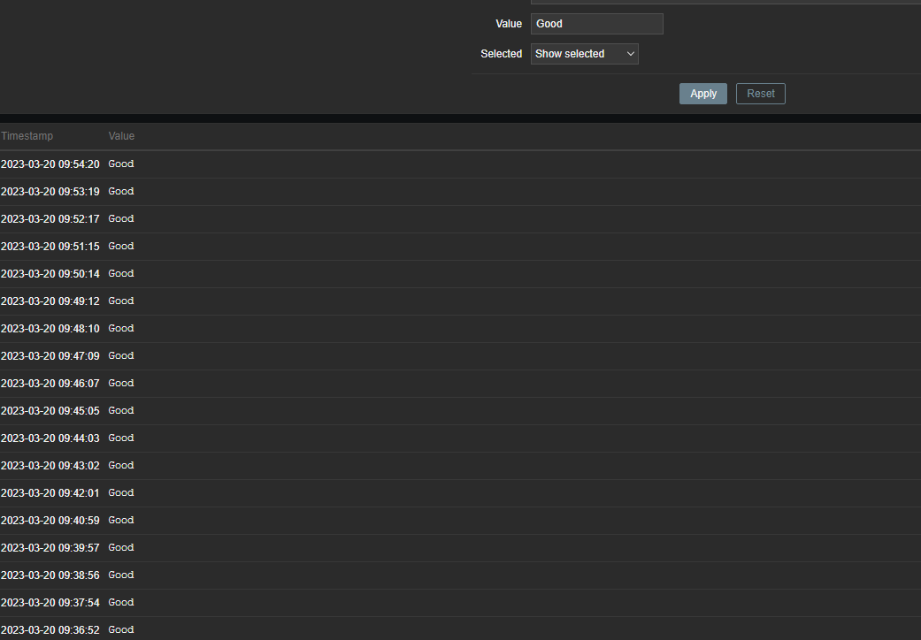

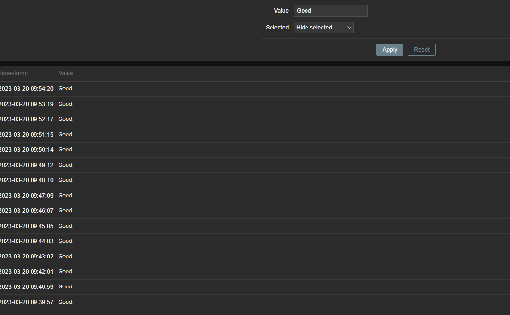

    Hello forum,I have a little problem with filtering latest data and meanwhile I think this might be a bug...
    Example:
    I have an item with a host that collects the string "Good" every minute. Once in a while I get the string "null" and an alarm triggers. Now I wanted to remove all strings "good" from the the list of strings shown to see, at what times I get the "null" string.
    Therefor I switch from the latest data tab to the filter tab, insert "Good" as my filter value and select "hide selected".
    But for some reason it still shows all the "Good" strings.
    I tried several other options like marking the value as red or the others as red, which works like expected. It is just "hide selected" that is not working.
    See attached sccreenshots:

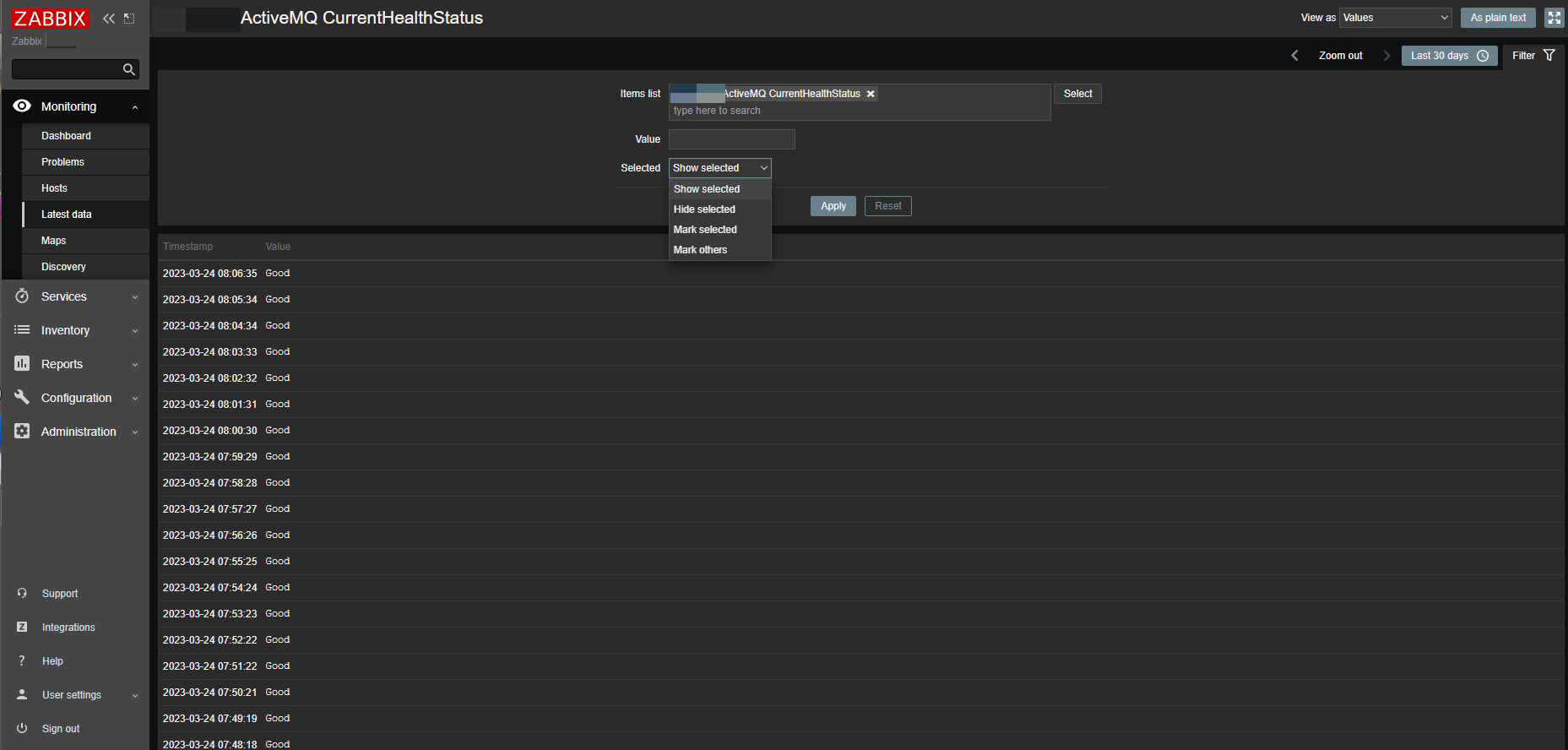

            The "hide selected" is not button but a menu point in the drop down menu.
            How can I prove I am not insane?

              Post a full window image showing the side menu.

                Screenshot atached!

                          • Hamardaban
                            • May 2019
                            • 2714
                            I found how to enter this mode! :-)
                            It appears for item with "Type of information​" = log
                            And in version 6.2.8 the filter works correctly! You can select or hide strings with the specified substring

                              yay! found it now.. Did not expect it to be there for just one type of data.. I guess I never needed it.. :P
                              And I can confirm, that in 6.0.13 this filter does not work properly. Selecting "Show selected" or "Hide selected" gives same result... selected pattern is shown.
