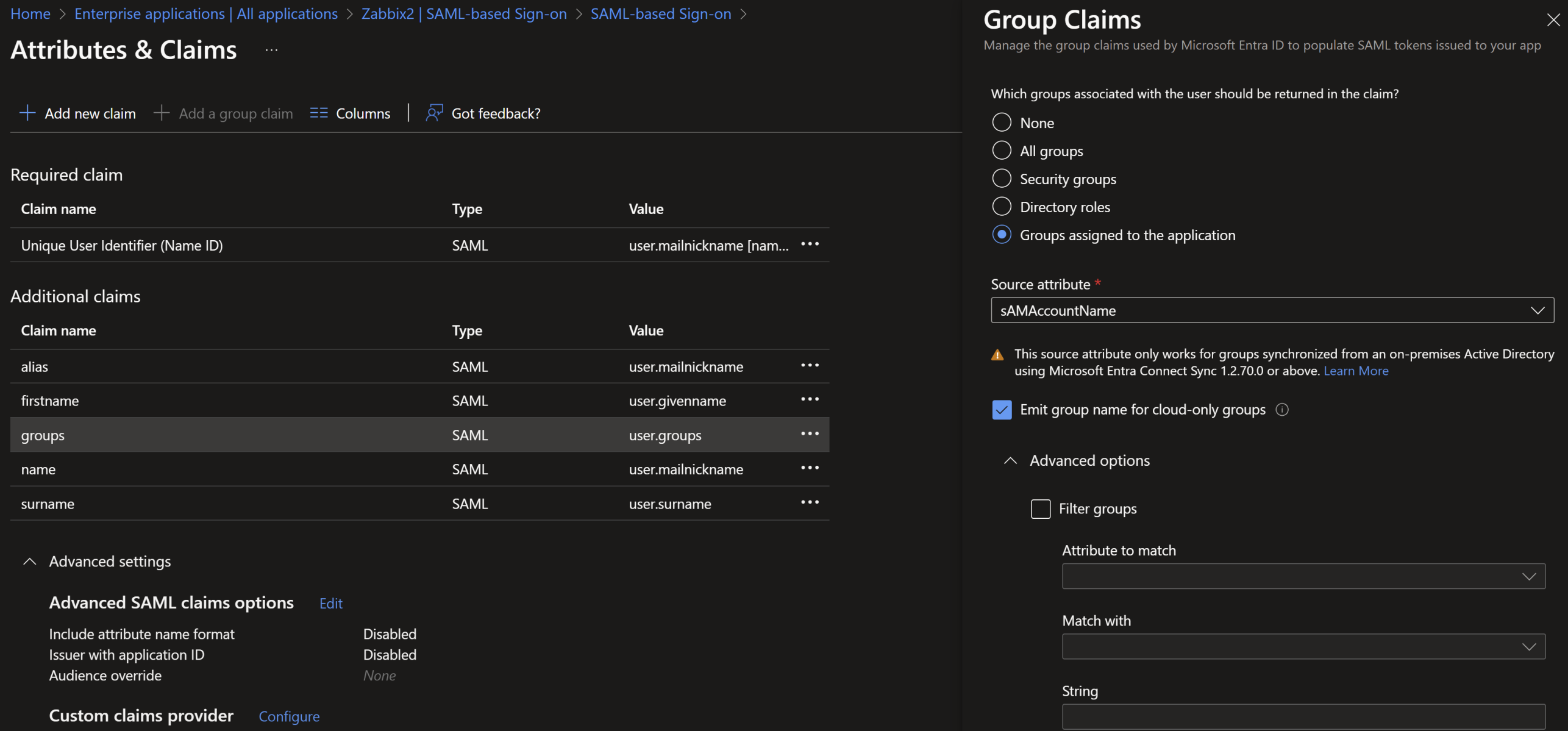

        • HB78
          • Mar 2023
          Just to close the topic, JIT is just working great now , my issue was more on Azure Claims !
          I had to change the group Claim i made.
          From ro_bitbussin answer i simply adapted the choice to be : Security Groups + select SAMaccountname ( the default was Group ID which is reporting ... ID and not names !)
          My custom Name stayed as is ("memberOf")
          That permit me to have multiple groups like XYZ-Admins, XYZ-Viewer, etc and then play with User Group mapping
          Just need to be sure not to have overlaps : user can't be viewer and admin , I presume ; not sure what happen

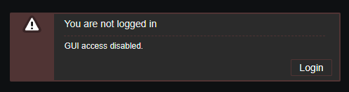

                Hi there,
                In my case every user is being provisioned with their roles and groups but when they try to login into zabbix they get this message:
                And when I go back to the user list in Zabbix, the user that tried to login go to the group disabled.
                Someone can help me ?
                Thanks!

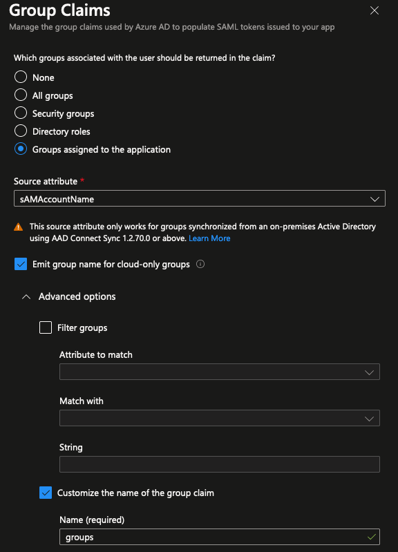

                  Hi guys,
                  I resolved my problem, was missing​ the to configure​ Group Claims in the Enterprise applications​​.
                  I customized the name of the group claim to groups, so we need to configure the same name in the front Zabbix Server. Group name attribute = groups

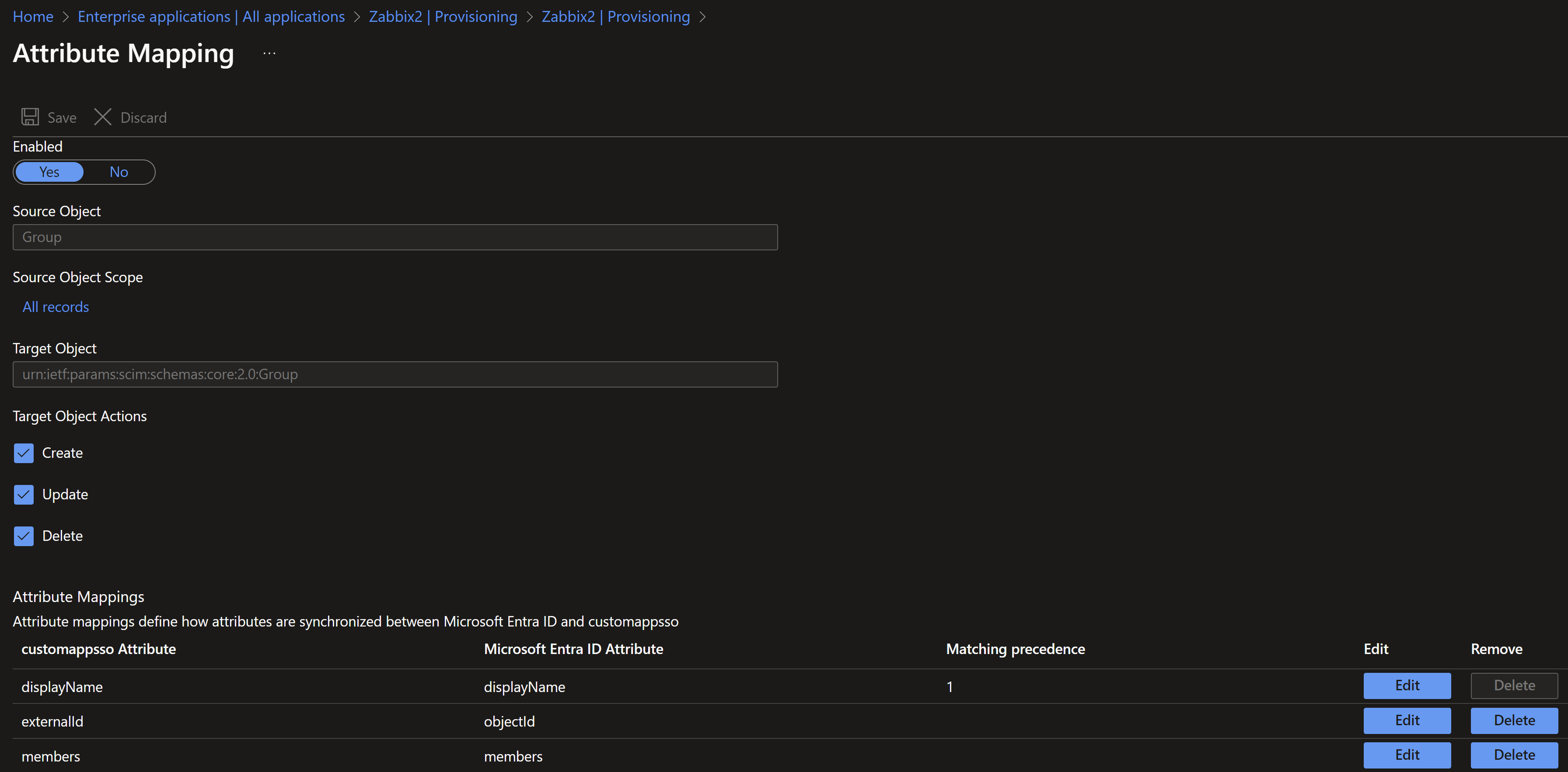

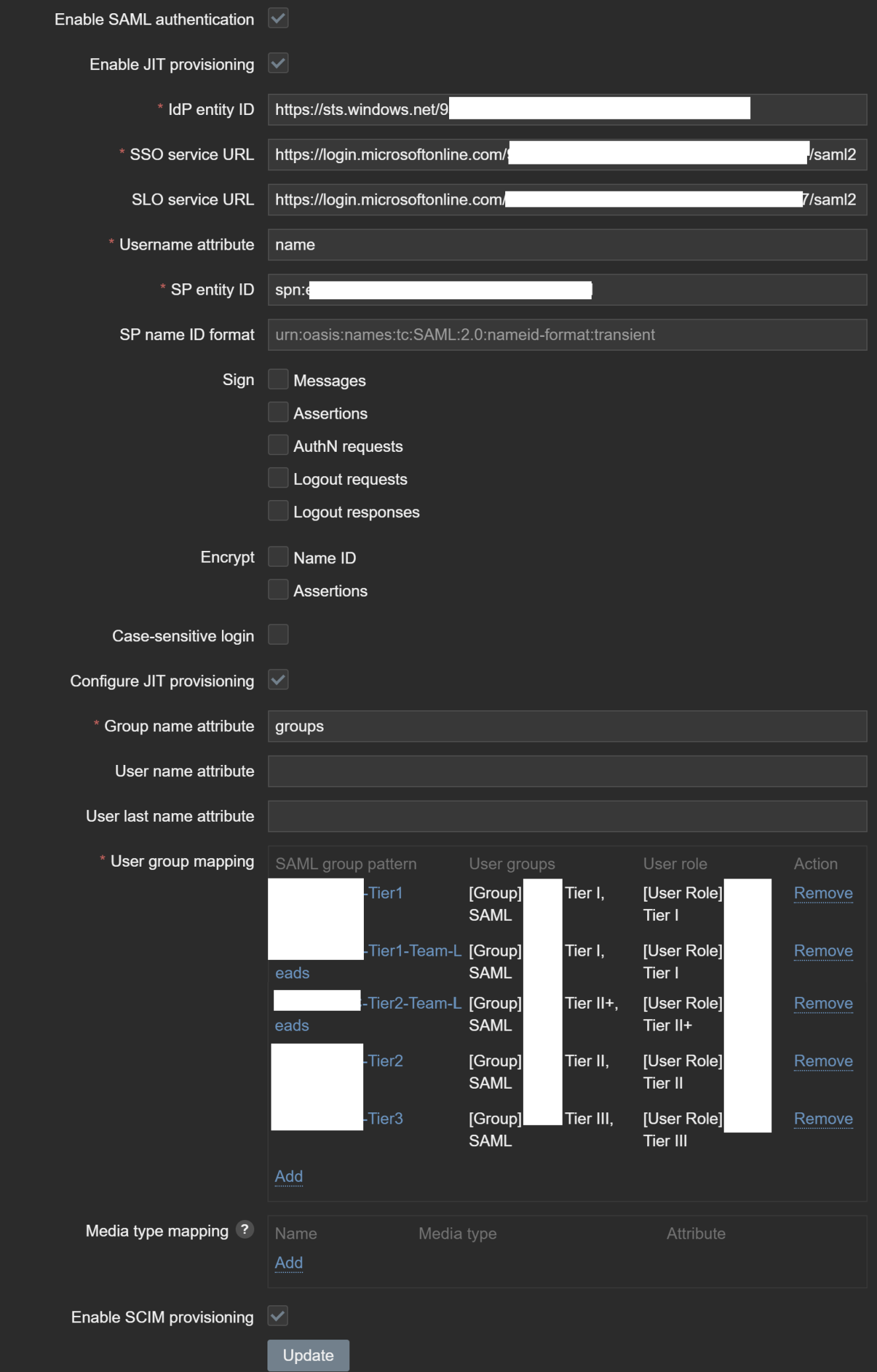

                    Going to pile onto this thread. We're also having issues with the SCIM setup. I've tried a variety of configs for Provisioning/claims, but can't get this to work. Is anyone able to point me in the right direction?
                    Edit: I should say what's wrong. We can get the accounts provisioned, but Zabbix isn't mapping our roles and groups correctly. Even trying fully generalized wildcards (Eg: the match pattern is '*', we can get this to map anything.
                    We're on Zabbix 6.4.8 (planned upgrade to 6.4.11 after change board approves), RHEL 9.3 64 bit. Standard apache build with PHP and a ton of hardening applied (CSP, X-Frames, HSTS, Information Disclosure, etc).
