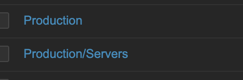

      Thank you, but I still don't think I understand, how do I make the subgroup? as I mentioned, if I create "Production" then try to create Production/Servers I get two different groups, one called production and one called production/servers, I want to create a hierarchy of groups, am I missing something in the way I ought to be setting it up? I thought that having the group structure was a good way of organising hosts.
      See here

        • 5004
        Unfortunately, that's how subgroups are in Zabbix... with such a long and cumbersome names.. It does not draw you a tree.. Full tree is in your group name..
        And if applying permissions, then you need to remember to reapply them, if you add another subgroup but previously added permissions to "include all subgroups".. it is just a shortcut to add all existing subgroup id-s to permissions at that moment... later addons, need reapplying...

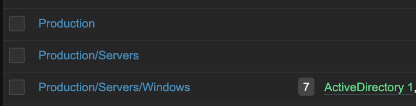

              Wow, ok, I have to say that doesn't make sense from a UX perspective at all to me.
              How do I know my group isn't just called Production/Servers/Windows because, as you say, the '/' character isn't a special char. if I have to have all the groups created sort of individually, how do you nest them?
              What I end up with is this do I not?

                • 5004
                Well your group is called "Production/Servers/Windows" ... "Nesting" comes to play only from the access permissions view... Where (I think by black magic) it manages to identify similarly "prefixed" groups and make assumptions, that those might be nested... and then you can give permissions with "include subgroups". Example : if you add usergroup x permissions to "Production" and "include subgroups" ... then In the end there are 3 records (based on your pic) in "rights" table per usergroup... -> usergroup X has permissions to hostgroup "Production", usergroup X has permissions to hostgroup "Production/Servers" and usergroup X has permissions to hostgroup "Production/servers/Windows",
                But then again, you may decide, that that usergroup x has only access to "production/servers/Windows", it does not have to have access to "Production" or "Production/Windows"..
