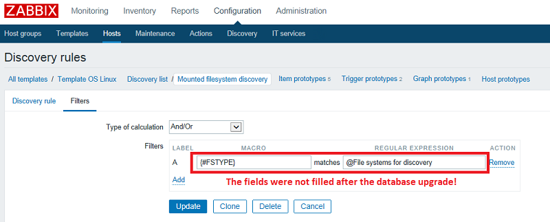

vfs.fs.discovery in zabbix version 3 now detects floppy, CD-ROM, USB mount point, e.g. /proc/bus/usb, the free space which is equal to 0. In the result of a lot of false triggers. Zabbix agent is used version 2.2. How can I fix it?
After upgrading from zabbix 2.2 to 3.0.3 problem with vfs.fs.discovery
Resolved in manual
After DB upgrade zabbix to version 3, disappeared the filter rules in LLD templates, e.g., {#FSTYPE} = @File systems for discovery; {#IFNAME} = @Network interfaces for discovery; and so on. Had to add a filter rule LLD manually in all templates. It's not a small job. The triggers had to be removed manually. A screen shot is attached.
I think updating the database from version 2.2 to version 3 ill-prepared developers. -
I think updating the database from version 2.2 to version 3 ill-prepared developers.Hello DmitrybHello zalex!

Regular expressions in Administration -> General -> regular, after the updates were in place. The problem was that the templates disappeared setting filters for LLD (low level discovery). See my post above.Comment
