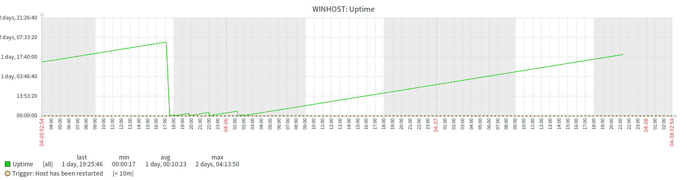

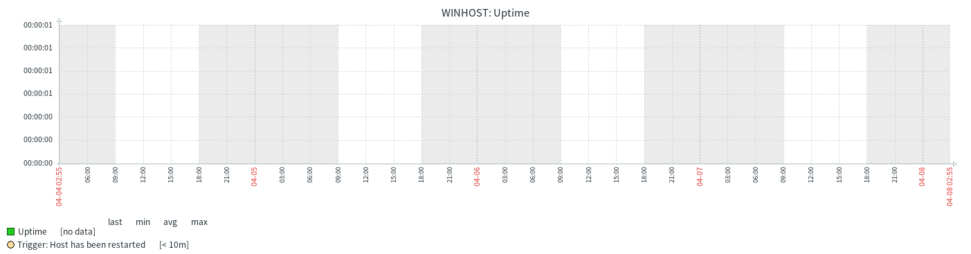

    Graphs work until I set interfal to 4 days or longer.
    Example:
    3 days:
    4 days:
    Zabbix 6.4 in docker compose.
    Checking and unchecking checkbox "Override item trend period" sometimes helps to show graphs, but this behavior is strange.
    Also, sometimes trends do not show since some time, while graphs of 3 days or shorter show the full graph

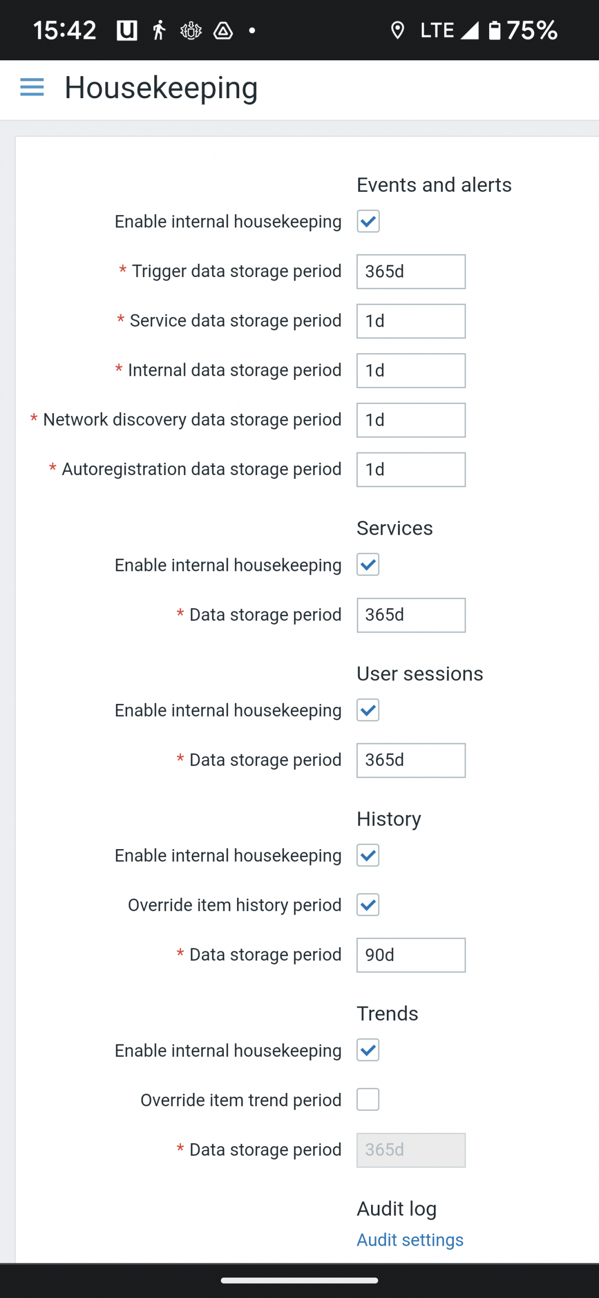

    • 4996
    What's your history and trend keeping periods?
    • aark
      • Apr 2023
      • 9
      90 and 365 days
