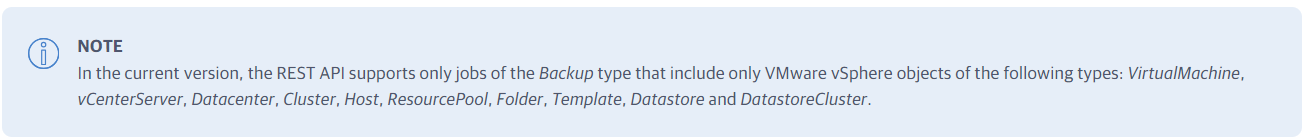

    I am trying to implement the Veeam by HTTP template on Zabbix 6.0 and I have figured that the jobs item do not work due to a limitation from the Veeam API itself
    Source : https://helpcenter.veeam.com/archive...r=110#tag/Jobs
    As it is my understanding, the API cannot get jobs that are of Hyper-V types.
    Does anyone have a solution ?
    I will be looking into it and post my solution if I have one.
    Regards.​
