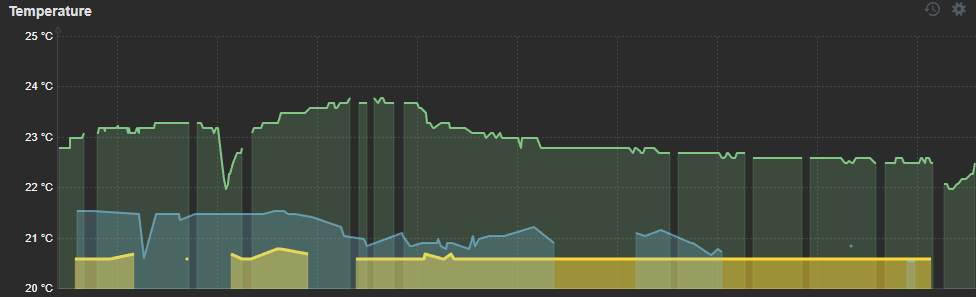

    Also here is a screenshot what i mean with our zabbix doesn't work correctly:
    Some data is just not written or can't be read
