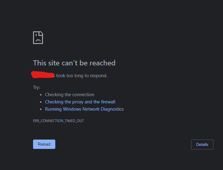

    I am new to Zabbix and setting up instances for some development. I have installed Zabbix 6.0 on CentOS 8 with the MySQL database. I have used the below guide to install it.
    https://www.zabbix.com/download?zabb...centos&os_vers ion=8&components=server_frontend_agent&db=mysql&ws =apache
    After installation, I tried to access the UI from remote server by using the "http://host/zabbix" and "http://host/zabbix/setup.php" url but I am not able to reach the server.
    Do I need to make any other change or have any additional step for this.​

    The problem was in the TCP firewall, I have added few rules in order to fix it.

      hello shubham.wagdarkar, you have to replace "host" in http://host/zabbix" "by the server IP address/FQDN.
        • 4972
        I am pretty sure that was edited out and replaced with "host" for privacy reason..
          oh, I see, you suppose you're right
          Anyway, according to the error message (ERR_CONNECTION_TIMED_OUT), it seems that there is a network issue between the web browser and the Zabbix web server: firewall filtering, routing issue, or something like that.
          • shubham.wagdarkar
            • Apr 2023
