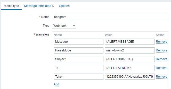

    Doesn't work BOLD in telegram media type
    Alerts - Media type - Telegram
    Problem started at {EVENT.TIME} on {EVENT.DATE}
    Problem name: {EVENT.NAME}
    \*Host: {HOST.NAME}\*
    Severity: {EVENT.SEVERITY}
    Operational data: {EVENT.OPDATA}
    Original problem ID: {EVENT.ID}
    {TRIGGER.URL} zz0.fe159j1h2wzz
    with ParseMode=markdownv2
    \*Host: {HOST.NAME}\* doesn't make bold text in triggers
    work only in test

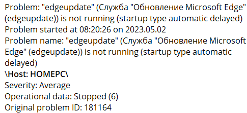

    Well.. Solution:
    use \* your bold text \*
    for markdown and markdownv2 to get this

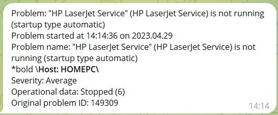

      • mshkondin
        • Apr 2023
        • 7
        when use *bold \*Host: {HOST.NAME}\*​​

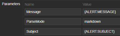

              With the help of GPT, he corrected part of the code, I tested it and it worked. Example of how to use Bold, use a *, and to break a line, use \n.
              Set ParseMode to markdon:
