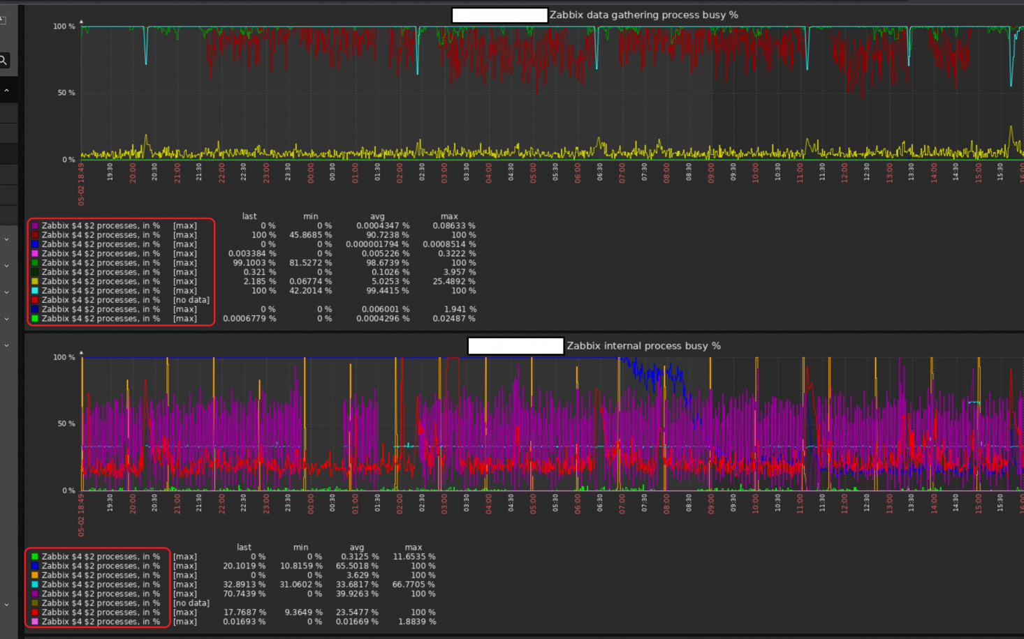

    Following a recent upgrade to 6.0.12 and database migration from MySQL to PostgreSQL& TimescaleDB we are seeing the following issue on the internal Zabbix Host graphs:
Name:	Zabbix Stats Problem 2023-05-03 at 18.52.51.png
    If you take a look at the legend beneath each graph, we see something like "Zabbix $4 $2 processes, in %" instead of the actual data gathering process names.
    Has anyone encountered this or solved it? Or is it a bug I should report?
    All comments gratefully received.
    D.

    Sadly, it's not a bug.
    Check the 6.0.0 upgrade documentation related to "Macros": https://www.zabbix.com/documentation...tes_600#macros

      Thanks for that Tim. I missed that little gem. Our system was running Zabbix 3.0 and we did a DB migration and upgraded to Zabbix 6.0. So it's no wonder we fell foul of that little gem.
      Solved by using the latest Zabbix server monitoring template.
      SOLVED.
