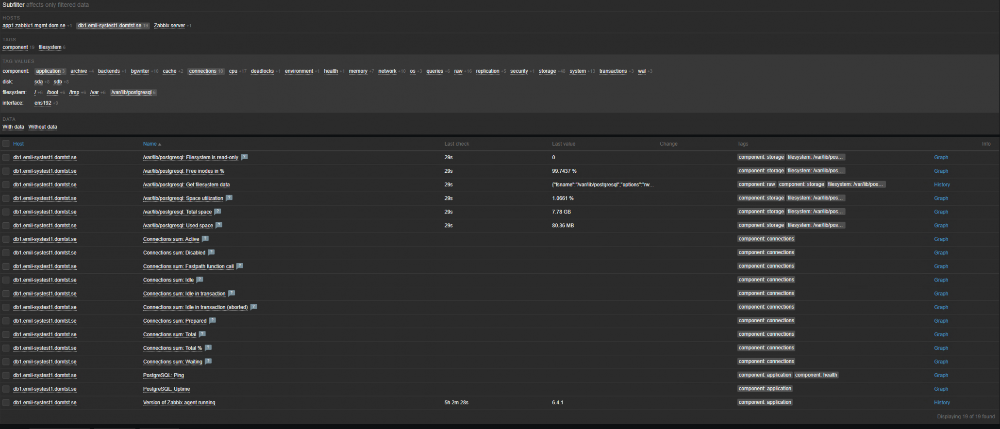

        Isn't zabbix_get if you run Zabbix agent?
        We run Zabbix agent2.
        In the gui I haven't found the button "Test" to be available for any item, it's greyed out.
        Even when I choose an item in the template "Linux by Zabbix agent active", which is working, the test button is greyed out.
        I can choose an item in the template for Postgres or Linux and click Execeute and then it reports "Request sent succesfully."
        But no feedback.
        Attaching a screenshot from Latest data showing some Linux items and some PostgreSQL items.
        Regards
        /Rickard
