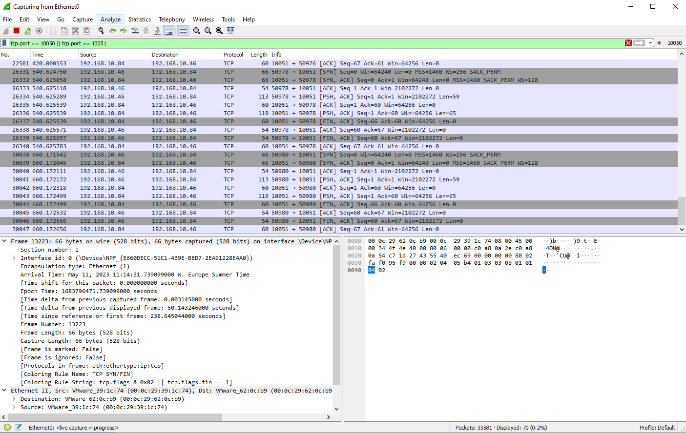

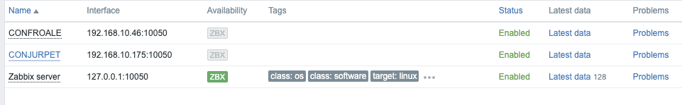

    And this is what i see in zabbix dashboard
Name:	Screenshot 2023-05-11 at 09.58.54.png
    I would appreciate any help in resolving this issue.

    7104:20230511:103547.617 12: C:\Zabbix\bin\zabbix_agentd.exe(SetProcessDynamicE nforcedCetCompatibleRanges+0xa46) [0x9f7b3cd6]
    7104:20230511:103547.618 11: C:\Zabbix\bin\zabbix_agentd.exe(RegQueryValueExW+0 x108) [0x9f733808]
    7104:20230511:103547.619 10: C:\Zabbix\bin\zabbix_agentd.exe(PdhCollectQueryDat a+0x5f93) [0x957e8f43]
    7104:20230511:103547.620 9: C:\Zabbix\bin\zabbix_agentd.exe(PdhCollectQueryDat a+0x6ea7) [0x957e9e57]
    7104:20230511:103547.626 8: C:\Zabbix\bin\zabbix_agentd.exe(PdhCollectQueryDat a+0x205af) [0x9580355f]
    7104:20230511:103547.627 7: C:\Zabbix\bin\zabbix_agentd.exe(PdhEnumObjectsHW+0 xa2) [0x958151b2]
    7104:20230511:103547.628 6: C:\Zabbix\bin\zabbix_agentd.exe(PdhEnumObjectsW+0x eb) [0x958152eb]
    7104:20230511:103547.629 5: C:\Zabbix\bin\zabbix_agentd.exe() [0x40039de5]
    7104:20230511:103547.630 4: C:\Zabbix\bin\zabbix_agentd.exe() [0x40039b0f]
    7104:20230511:103547.631 3: C:\Zabbix\bin\zabbix_agentd.exe() [0x4003a641]
    7104:20230511:103547.631 2: C:\Zabbix\bin\zabbix_agentd.exe(WaitServiceState+0 x328) [0xa155dfd8]
    7104:20230511:103547.632 1: C:\Zabbix\bin\zabbix_agentd.exe(BaseThreadInitThun k+0x14) [0xa1887614]
    7104:20230511:103547.632 0: C:\Zabbix\bin\zabbix_agentd.exe(RtlUserThreadStart +0x21) [0xa1c226a1]
    7104:20230511:103547.637 ================================
    7104:20230511:103547.659 Unhandled exception 6ba detected at 0x00007FFC9F72CF19. Crashing ...
    7104:20230511:103547.660 ====== Fatal information: ======
    7104:20230511:103547.664 Program counter: 0x9f72cf19
    7104:20230511:103547.665 === Registers: ===
    7104:20230511:103547.665 r8 = 1f46857d4 = 8395446228 = 8395446228
    7104:20230511:103547.678 r9 = d3c720 = 13879072 = 13879072
    7104:20230511:103547.679 r10 = 7ffca1bfb86b = 140723022182507 = 140723022182507
    7104:20230511:103547.679 r11 = 0 = 0 = 0
    7104:20230511:103547.680 r12 = 5c8740 = 6063936 = 6063936
    7104:20230511:103547.683 r13 = 6ba = 1722 = 1722
    7104:20230511:103547.684 r14 = 0 = 0 = 0
    7104:20230511:103547.684 r15 = d3d5a0 = 13882784 = 13882784
    7104:20230511:103547.684 rdi = 7ffc9038b018 = 140722728120344 = 140722728120344
    7104:20230511:103547.685 rsi = 0 = 0 = 0
    7104:20230511:103547.686 rbp = 5 = 5 = 5
    7104:20230511:103547.688 rbx = 6ba = 1722 = 1722
    7104:20230511:103547.689 rdx = 0 = 0 = 0
    7104:20230511:103547.689 rax = 7ffca1bfb86b = 140723022182507 = 140723022182507
    7104:20230511:103547.690 rcx = 0 = 0 = 0
    7104:20230511:103547.692 rsp = d3d2e0 = 13882080 = 13882080
    7104:20230511:103547.693 efl = 206 = 518 = 518
    7104:20230511:103547.693 csgsfs = 332b5300 = 858477312 = 858477312
    7104:20230511:103547.694 === Backtrace: ===
    7104:20230511:103547.770 24: C:\Zabbix\bin\zabbix_agentd.exe(RaiseException+0x6 9) [0x9f72cf19]
    7104:20230511:103547.771 23: C:\Zabbix\bin\zabbix_agentd.exe(RpcRaiseException+ 0x50) [0xa11102c0]
    7104:20230511:103547.772 22: C:\Zabbix\bin\zabbix_agentd.exe(RpcRaiseException+ 0x14) [0xa1110284]
    7104:20230511:103547.772 21: C:\Zabbix\bin\zabbix_agentd.exe(Ndr64AsyncServerCa llAll+0x1599) [0xa11bd7d9]
    7104:20230511:103547.773 20: C:\Zabbix\bin\zabbix_agentd.exe(NdrClientCall3+0xf 0) [0xa11c05b0]
    7104:20230511:103547.773 19: C:\Zabbix\bin\zabbix_agentd.exe(I_BrowserQueryStat istics+0x3d) [0x903827ad]
    7104:20230511:103547.774 18: C:\Zabbix\bin\zabbix_agentd.exe(CloseNetSvcsObject +0x13ba) [0x91a127fa]
    7104:20230511:103547.775 17: C:\Zabbix\bin\zabbix_agentd.exe(CollectNetSvcsObje ctData+0xf3) [0x91a113e3]
    7104:20230511:103547.776 16: C:\Zabbix\bin\zabbix_agentd.exe(InitiateShutdownW+ 0xa0b) [0xa139a0bb]
    7104:20230511:103547.776 15: C:\Zabbix\bin\zabbix_agentd.exe(InitiateShutdownW+ 0x1630) [0xa139ace0]
    7104:20230511:103547.777 14: C:\Zabbix\bin\zabbix_agentd.exe(PerfRegQueryValue+ 0x1a05) [0xa138af35]
    7104:20230511:103547.778 13: C:\Zabbix\bin\zabbix_agentd.exe(PerfRegQueryValue+ 0x3b) [0xa138956b]
    7104:20230511:103547.779 12: C:\Zabbix\bin\zabbix_agentd.exe(SetProcessDynamicE nforcedCetCompatibleRanges+0xa46) [0x9f7b3cd6]
    7104:20230511:103547.779 11: C:\Zabbix\bin\zabbix_agentd.exe(RegQueryValueExW+0 x108) [0x9f733808]
    7104:20230511:103547.780 10: C:\Zabbix\bin\zabbix_agentd.exe(PdhCollectQueryDat a+0x5f93) [0x957e8f43]
    7104:20230511:103547.781 9: C:\Zabbix\bin\zabbix_agentd.exe(PdhCollectQueryDat a+0x6ea7) [0x957e9e57]
    7104:20230511:103547.782 8: C:\Zabbix\bin\zabbix_agentd.exe(PdhCollectQueryDat a+0x205af) [0x9580355f]
    7104:20230511:103547.783 7: C:\Zabbix\bin\zabbix_agentd.exe(PdhEnumObjectsHW+0 xa2) [0x958151b2]
    7104:20230511:103547.785 6: C:\Zabbix\bin\zabbix_agentd.exe(PdhEnumObjectsW+0x eb) [0x958152eb]
    7104:20230511:103547.786 5: C:\Zabbix\bin\zabbix_agentd.exe() [0x40039de5]
    7104:20230511:103547.786 4: C:\Zabbix\bin\zabbix_agentd.exe() [0x40039b0f]
    7104:20230511:103547.788 3: C:\Zabbix\bin\zabbix_agentd.exe() [0x4003a641]
    7104:20230511:103547.789 2: C:\Zabbix\bin\zabbix_agentd.exe(WaitServiceState+0 x328) [0xa155dfd8]
    7104:20230511:103547.790 1: C:\Zabbix\bin\zabbix_agentd.exe(BaseThreadInitThun k+0x14) [0xa1887614]
    7104:20230511:103547.791 0: C:\Zabbix\bin\zabbix_agentd.exe(RtlUserThreadStart +0x21) [0xa1c226a1]
    7104:20230511:103547.795 ================================
    7104:20230511:103548.014 agent #0 started [main process]
    7728:20230511:103548.016 agent [NODE="1"]Home[/NODE] started [collector]
    6980:20230511:103548.016 agent [NODE="2"]Forum[/NODE] started[listener #1]
    4252:20230511:103548.017 agent #4 started[listener #3]
    2316:20230511:103548.017 agent #3 started[listener #2]
    7996:20230511:103548.018 agent #5 started [active checks #1]
    I install wireshark to analyse traffic and it looks normal too..
    • xquadro
      • May 2023
      Ok, problem solved. I just should apply the template to host.
