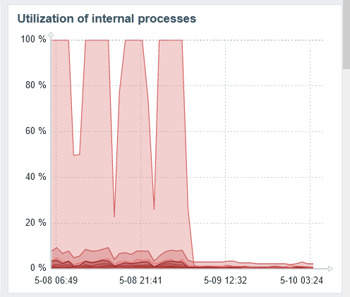

    We encountered a permanent use of housekeeper after our upgrade.
    Zabbix 6.0.3 --> zabbix 6.4.1 (all Zabbix components except agent-zabbix)
    Postgres 13 --> postgres15
    TimescaleDB2.4 --> TimescaleDB2.10
    We had an SQL query running in a loop, 400 seconds long.

    The missing index has been created, the request now executes in 40ms and the housekeeper has returned to normal behavior.
