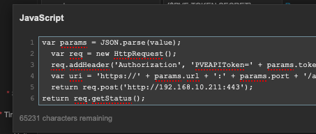

    This is my test script: (you may only focus on the second last line)

    So, the test results is like this:

    And this happens to every other pages, ***EXCEPT 80 and 443. ***
    Which means, no matter is http or https, if the page is on port 80 and 443, it will work. Below is example using port 443 but through http:
