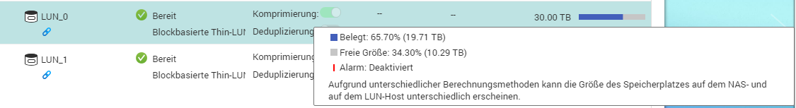

    While if I go directly to the NAS it shows that only around 20TB are in use:​

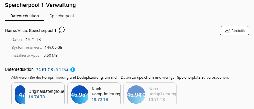

    While compression is active, it is not nearly enough to account for 7TB of data:

    What other ways (graphical, cmd, PowerShell) do you have in Windows that you can use to get the disk usage? What are they reporting?
    Markku
    • christianm
      christianm commented
      Thanks for the hint, Markku! Since its shown as a folder in the explorer I didnt realize that I can actually see the capacity of the mounted drive when looking into its properties. Rookie mistake on my side.
      Of course it also shows the wrong size and therefore its not an issue with zabbix itself. I will look further into it and know where to look now.
      Thanks a bunch! Have a great day!
