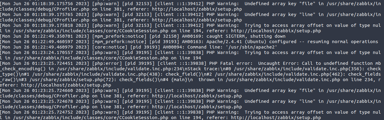

    Error while installing Zabbix 6.0.4
    PHP Versions: 7.3, 7.4 and 8.1. All tested.
    Apache Log:
Name:	Captura de tela de 2023-06-26 01-28-50.png
    This is caused by clicking "Next" on the Zabbix installation home page, where when clicking Next, error 500 occurs.

    There have 14 subsequent releases in the the 6.0.x series, so if you're doing a fresh install, why not start with the current version, 6.0.18?
    The "undefined function" message mentions a function that starts with "mb_". Are you sure you have the PHP mbstring extension installed and activated? Have you made sure that you have all the requirements met for the "Frontend" part of the Requirements document: https://www.zabbix.com/documentation...n/requirements

      After installing php8.1-mbstring, I was able to run the installation, thanks
