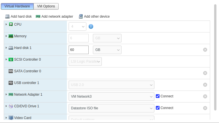

      1) My server specs:
Name:	Screenshot from 2023-07-26 10-45-34.png
      2) No.

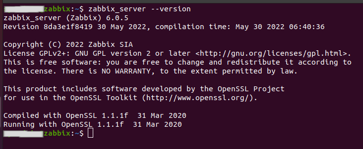

      6) Sure:
Name:	Screenshot from 2023-07-26 10-59-51.png

        Looks fine, maybe a little memory starved from minimum required specs. (Though, if it hasn't thrown memory alerts yet, I wouldn't worry about that either). 2 Requirements (zabbix.com)​ I wouldn't worry about the disk warning unless it keeps happening.
        The only suggestions I would have is to move the storage of the Zabbix DB onto a dedicated disk or server. Depending on the partitioning of the OS, you may stand to fill the root partition which can cause issues with Linux. The other one being patching - Zabbix Server 6.0.19 is out for LTS. Version 6.0.5 is over a year behind on patches.
