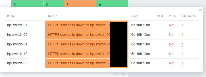

    Hi all,

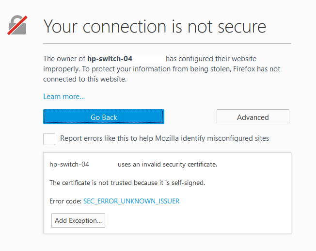

    I am running Zabbix Server on Ubuntu 14.04.4 LTS, and I'm monitoring some HP ProCurve 2530 switches, which have HTTPS enabled, but the server shows them as down. Zabbix doesn't check the validity of the SSL/TLS certificate right? Because in the browser I can access the page, but it gives me an error (Error code: SEC_ERROR_UNKNOWN_ISSUER).

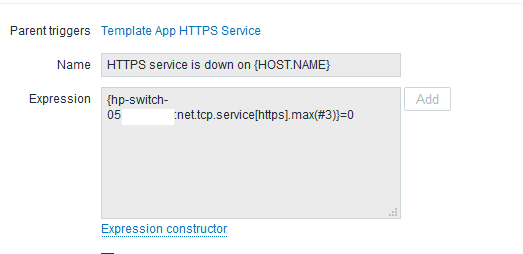

    1. Attach a screenshot of the item keys you're using for HTTPS monitoring

      Are you checking it with a simple check using "https" as a parameter? I found on ubuntu that it was failing due to a change in (if memory serves) curl that removed certain SSL/TLS versions from being accepted as valid. Some (many) network devices may be running older code and so supporting (only) older less secure protocols.
      You can make it just check that the port is open by changing it to "tcp" to port 443 as opposed to the explicit name "https". Same goes for telnet and a few other protocols, putting the protocol name in does some extra checks that sometimes fail (telnet for example I ran across recently as it does not honor subnegotiation so it fails). That would ensure your issue lies in the detail and not just passing traffic.
      Of course changing from "https" to "tcp" (being sure to put in 443 as the port) may not be what you want since it does not check that the connection actually works, just that the port is open.

        Yes, I am running a simple check which checks https rather than the availability of port 443. There are also no firewalls between the Zabbix Server and the switches I am monitoring.

            Yes, I did get a "connection refused" error using curl on HTTP, but when I curl on HTTPS it shows a certificate error, and with the -k parameter it works fine.
