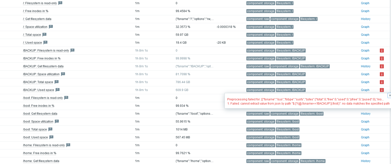

    After switching, the filesystems are all discovered, but the data for ONE filesystem cannot be retrieved anymore:
    Only one filesystem fails, there are no problems with the others.
    The message is:
    Preprocessing failed for: [{"fsname":"/sys","fstype":"sysfs","bytes":{"total":0,"free":0 , "used":0,"pfree":0,"pused":0},"ino...
    1. Failed: cannot extract value from json by path "$.[?(@.fsname=='/BACKUP')].first()": no data matches the specified path​​

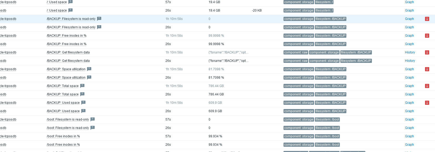

    Out of curiosity I reinstalled the Agent (not Agent2) on another port, and the data for that filesystem are immediately retrieved without a problem, even with the two agents coexisting:

              Also, it looks like every now and then the agentd gets values for that filesystem also from agentd, at apparently random intervals:
              On that vm SELinux is installed. Don't know if this is relevant.

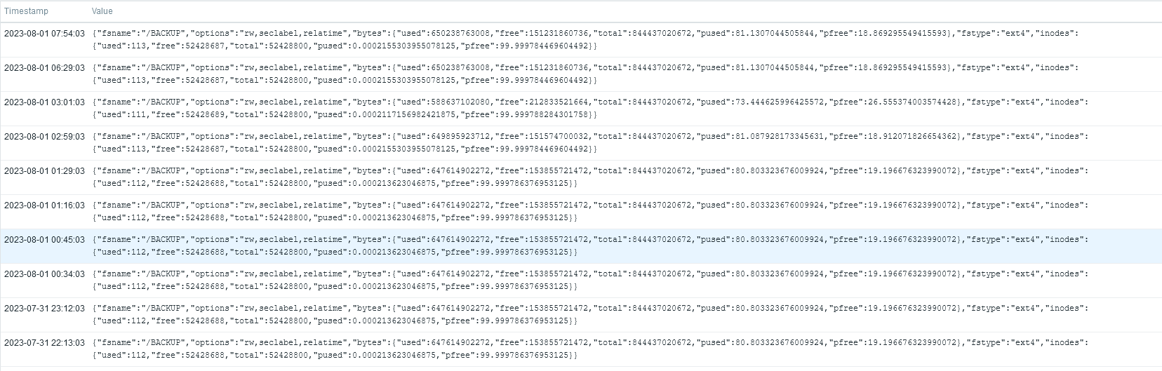

                    • Dec 2022
                    • 43
                    Here's the first few history data for that filesystem after setting longer item history. It seems that there is nothing wrong with it, except the random intervals at which the filesystem can be seen by agent2.
                    Again, agentd has no problems at all with this.
