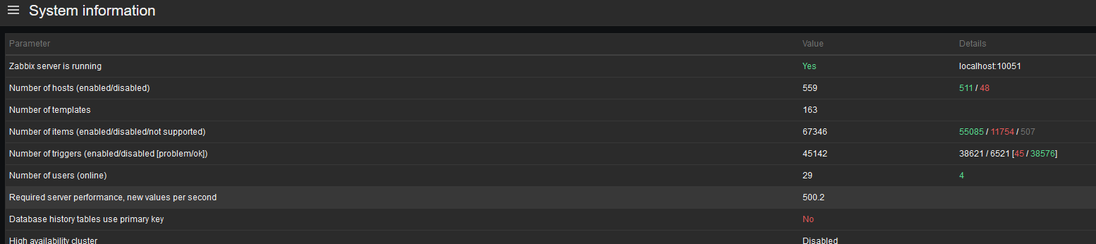

    Hello, Some time ago I got the following alert "Zabbix history syncer processes more than 75% busy".​
    This alert appears when I try to navigate between my dashboards and makes them load forever. I attached pictures for clarity.
    Zabbix Version: 6.0.19
    BD: MariaDB
    S.O: Ubuntu 20

      Those peaks are when I navigate between dashboards and change the time interval, which is when the alert is generated and the zabbix freezes.
      Current configuration:
      Also, I can't find information about "StartPollerHistory" in the configuration file and in the log /var/log/zabbix/zabbix_server.log I only find errors like:
      "Failed: cannot extract value from json by path "$[?(@.Name == "1")].PercentDiskTime.first()": no data matches the specified path
      1752:20230803:234022.671 error reason for "SERVER:vfs.dev.write.rate[DiskWritesPersec.1]" changed: Preprocessing failed for: [{"AvgDiskBytesPerRead":"0","AvgDiskBytesPerTran sfe r":"297642 ","AvgDiskBytesPerWrite":"297642","A..."​
      Thank you very much in advance.
        • 5004
        Fix your DB and add primary keys... your screenshot show red "No" for those... It will speed up db usage. https://www.zabbix.com/documentation...0#primary-keys
        Suggested "StartHistoryPollers" change is irrelevant, as those are used for calculated checks. It does not affect history sync. Same with timers and escalators, not used for history sync...

          Sorry, I'm new to this, what do you mean by "Fix your DB" and adding this primary keys will affect the production environment? my zabbix database currently weighs approx 87GB
            • 5004
            Did you read the link? there are further links to pages depending on your DB type... if it seems like klingon, then ask you friendly DBA to explain...
